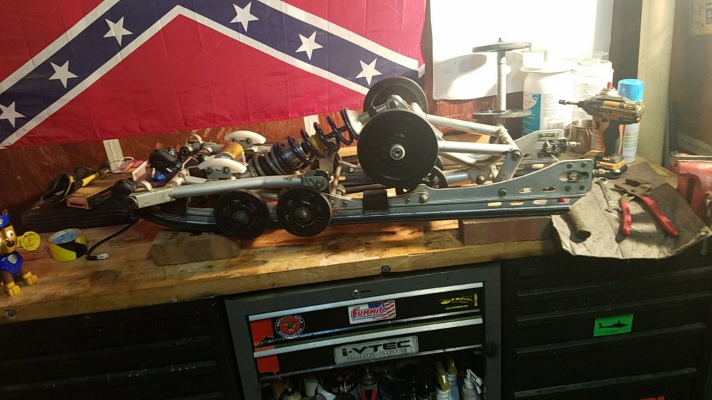

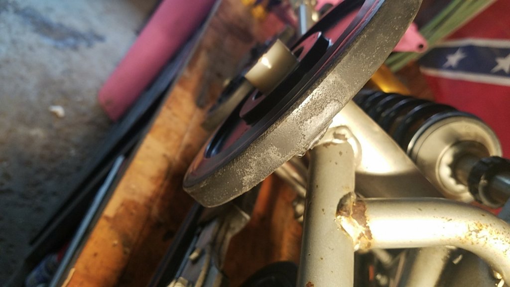

I love this site , yes everyone here is extreamly helpful and I've learned so much from being on here , otherwise I'd be guessing lol ... I was a mechanic by trade for 7 years and been around cars my whole life from a family of mechanics so this all comes natural , but the techincals of these machines is new to me .. I now make aerospace drive and PTO shafts .. witch sounds fancy but it's really not lol , but it keeps me paid and still get to dip into mechanics . I only ran it without the belt as a test basically after I had got the motor and all the components back togeather to make sure I didn't miss anything and it was all running how it's supposed to .. I buttoned up the engine and all last nite , and now I'm working my way into the skid .. I dropped the skid last nite .. witch by the way was the easiest skid ive ever dropped , the front arm layes down ans the whole skid is flat ! Comes out so easy , I've got it on the bench now and checked over all the arms and bushing witch all look great , but bassicly every idler wheel except the outside front ones are toast .. the back 3 main wheels bearings were all locked up and the rest and loud and loose . I'm not sure witch ones have replaceable bearings if any ... Plus some of the wheels look rough .. pitted and some have started to delaminate ... I'll also prolly be putting a 4th wheel kit on from BOP

the rear outer wheels in your pic are non serviceable bearings in them. the others look to be fine for replacing the bearings. the pic you took of the rubber on the wheel is showing me that it is good. all my wheels look like that on all my sleds. the ones that i replace for delaminating have the rubber cracking away at the plastic on the wheel. the aluminum ones go the same way.

Yes the back axle wheels with the grey hubs are not serviceable ... The others seem like maybe ? The ones in question are the bigger idlers in top where the rear mounts for the skids are. They dont seem serviceable.. the front four "outter" wheels were replaced last year
