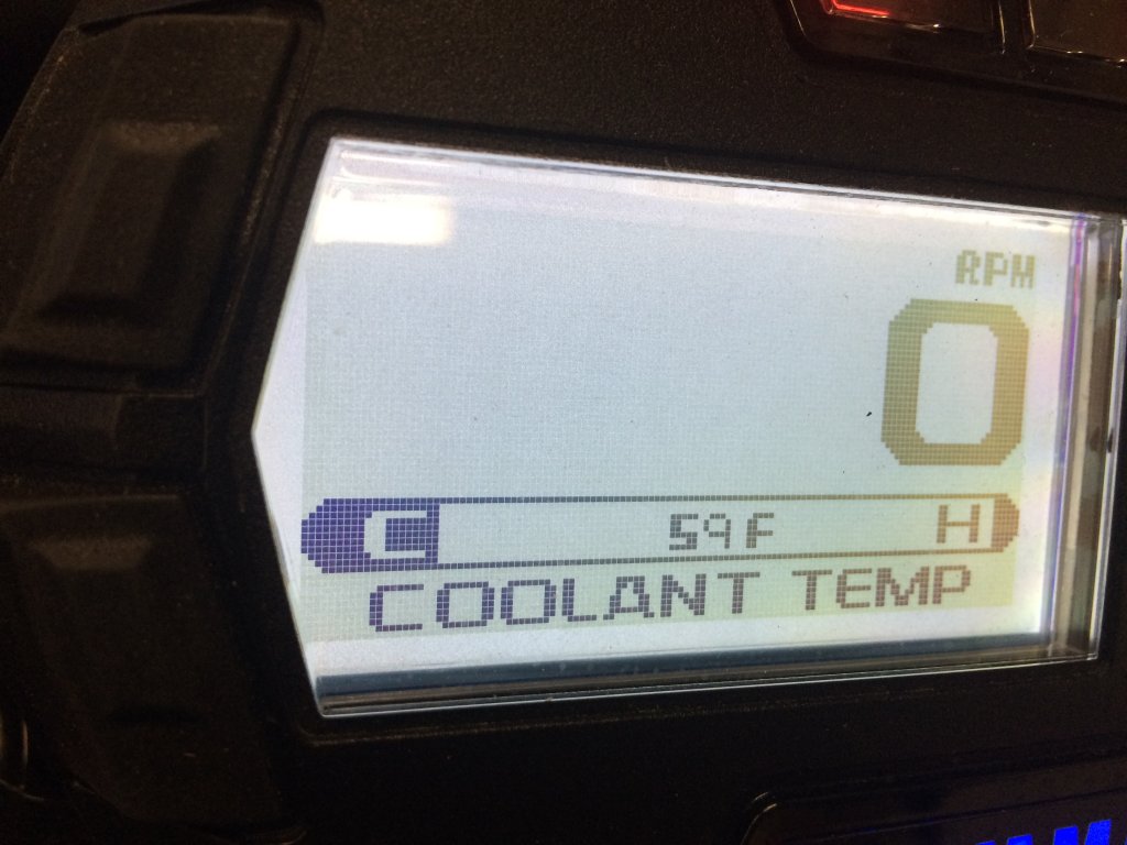

only went for one ride so far...but is there are way to display coolant temp in degree's and not just the bar across ? Mine seemed to stay a little over halfway to the H
Press and hold the lower left hand button until the numbers show up
