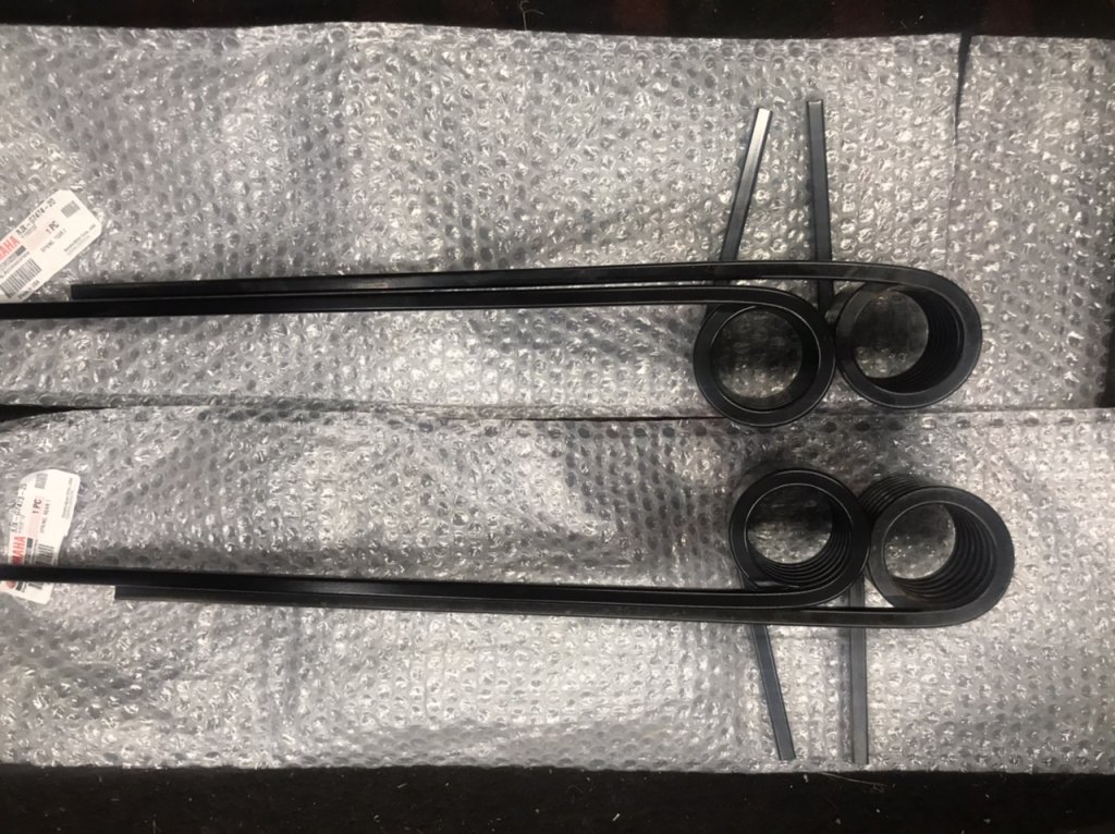

Our 2020 LTX-GT started out just fine, around 1,200 miles I noticed it was sitting lower on the trail then my 17 SW LTX-LE. By 1,600 miles it was less than a half inch off the transfer blocks empty, on them with a rider. As I previously posted, we double checked the mounting, friction points, both shocks and it was the torsion springs. My wife is 160# so we didn’t want the HD fat boy springs. My dealer suggested the hi-lift springs which have 10 degree more coil but are the same diameter of the originals. Once those were installed, problem solved. We put another 1,100 miles on these and they worked fantastic. Great ride and absolutely no sag. She’s a happy rider.
This is the difference between the SRX torsions and the previous 137” springs.

Would the ones on the right give the sled more up spring ?This is the difference between the SRX torsions and the previous 137” springs.
That spring is from a 600 Transporter.My wife’s 2020 LTX-GT had the same problem last month. The dealer replaced the rear QS3 pulled and inspected the front rear shock. (No problem) That did not solve the problem, so they ordered new springs. Once installed problem solved. We put in spring # SMA-8JP47-71. Supposed to be a 10 degree more twist in the coil for additional lift. Original diameter. Have put over 1,200 miles on it since then. Working perfectly, no more sag.
Yes for sure.Would the ones on the right give the sled more up spring ?

I’m guessing the srx springs are on the left?

Yes but I messed up. The SRX springs are not what is in all the other sled. Deleted that post. 8JX-G7473-00-00 is what is in all the other 137'sI’m guessing the srx springs are on the left?
Yes sorry. So to get a higher rate spring the Transporter spring is probably your best bet but I have not compared them.I just checking the parts diagram here in Canada and it shows 8JX-G7474-00-00 —
