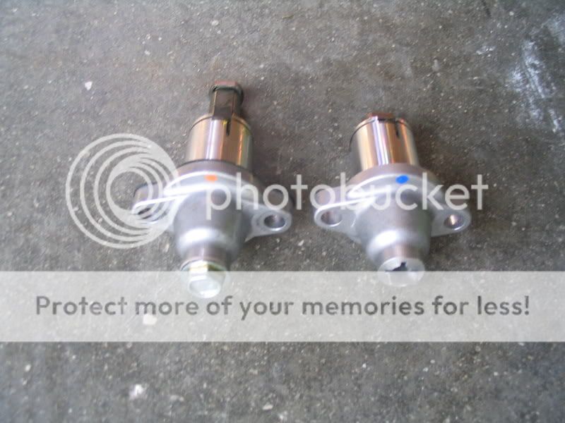

I talked to my Yamaha friend today. I sent him the bulletin yesterday and he'd seen it before when it first came out in 2005. He said the tensioner is automatic and doesn't need the owner's help in doing its job. He said the failures Yamaha was seeing was due to owners tightening their adjusters improperly. If you remove the bolt from the back of the adjuster, you can push it further in with a center punch. There were owners who were concerned about noise and tried to quiet their sleds down by tightening their tensioners. There were also owners (like I mentioned earlier) who did work or modified their sleds and didn't properly reassemble and install everything (including their tensioners) and experienced a failure.
He said if I was going to have a tensioner failure it would have happened already. The dots are Yamaha's way to alert service personnel whether the sled has the stock tensioner (orange dot) or had a replacement tensioner installed (blue dot). He also mentioned that there had not been a single failure documented in Alaska. But that info is probably about a year or two old.

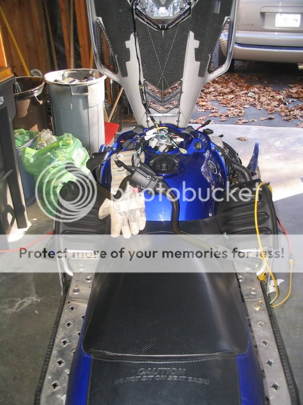

I spent the weekend updating the cam chain tensioner in my '06 Rage. Hope this helps anyone thinking about doing this upgrade.
Parts List:
10-8ES-12210-01-00 Cam Chain Tensioner Assembly
10-4FM-12213-00-00 Tensioner Gasket
10-8FA-14623-00-00 Exhaust Pipe Gasket (3)
Remove handlebars and controls.
Remove seat.
Remove Fuel Tank

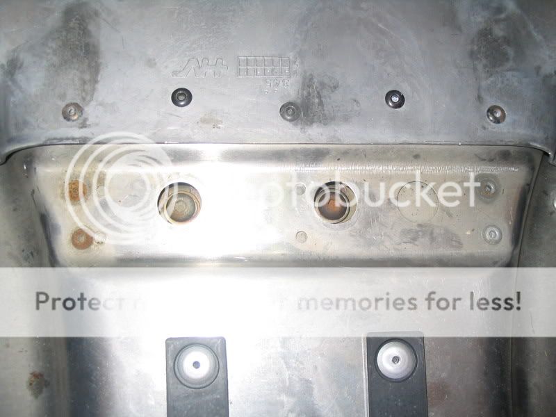

Remove these two exhaust mounting bolts hidden under rubber plugs.

Old Style tensioner with orange dot on left. New style (blue dot) on right. Tab on new tensioner holds spring in place and is removed after installation.

Parts List:
Remove seat.
Remove Fuel Tank
