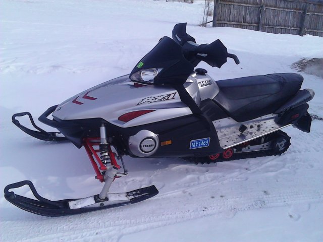

I should have updated this old post.Morning all, I have a 03 and love sled, start it in garage every.couple weeks and warm it up to 175, I can't stand listening to this damn clutch or bucket of bolts any more, just hate to not get real users opinion on who's to order, I am sure some a better with noise than other's, or is it better to find a used.clutch from another model sled? Thanks for any help.View attachment 108211
I had Schmidt Bros rebuild both clutch's
With helix change (replaced all bushings.
And it is about 50% quoted and performs super.
