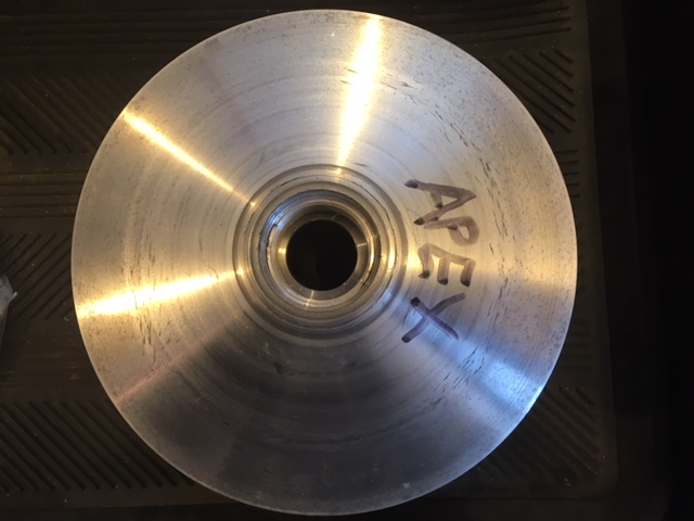

I have the primary clutch off of my 2019 Winder.
For info:
The fixed sheave on the Sidewinder clutch is the same diameter of the Apex clutch [8.25"] … clutches also have the same 30mm taper. If you need to change your Sidewinder clutch an Apex primary should work fine....once its calibrated
In the pictures I have an old Apex fixed sheave over laying the SW clutch to show the similarity in size.

IMO:
I like the Yamaha primary clutches. I have been using them on every Yamaha I have owned since this clutch design first showed up on the 1995 Vmax4 800s.
The Yamaha primary has proved to be reliable and easily tuned on all my sleds from Stock Vmax 4s, 600+700 SX improved stockers, 2002 SRX, Mod 866 Vmax 4 drag sled that ran at 10,200 rpm[9500+ clutch RPM], stock Apex, and 350 hp Super Charged Apex.
The only item I see as an issue on my 2019 Sidewinder is the lack of set screws to retain the pin for the rollers on this newer version of the original primary clutch, this obviously contributes to the rattle the 998 triggers in the Yamaha primary although the weights will still rattle on these clutches unless the weight profile and roller size are changed to eliminate the clearance that exists between the roller and fly weight before the primary begins to close up.
The only clutch change I may make to my Sidewinder is to install and calibrate a new Apex Primary I have somewhere in my parts heaven..lol if I can find it
JM.02c

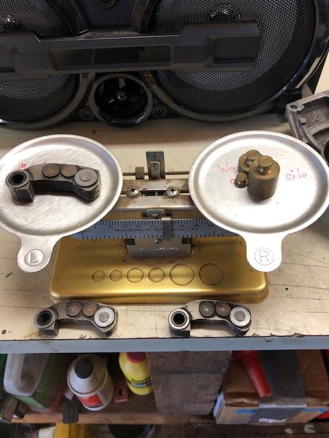

What is your total weight with the 8LR's? I've added on the side of mine with the mig welder and am running 78 grams, which may be a tick heavy.I am not considering replacing stock clutches. Yes primary clutch is noisy, but so far with 4500 miles, they still work fine. Secondary rollers were replaced under warranty after only 500 miles.
If the stock weights are 8LR, Total weight is at 73.8 - 73.9.
Originally this was my dealer’s set up. He told me they added a 1.5 gram washer to the tip.
My rpm’s were a bit low so I ground a bit off that tip weight.
Now the rpms are right where I want them 8900- 9000 . Engagement at 2650 and cruising speed rpms are kept at a decent level. I have heard from a friend who just bought some rivets and washers from dealer, and they have changed it up a bit for this newer Max Spool 16 / 3 bar tune. He is really good and passes on his set ups to even people who bought sleds elsewhere, but buy parts and service through him. I think I got same results by changing secondary twist from6/2 to 6/1 when I got the new updated 16 flash. 1400 miles on belt so I decided to change it because we run very hard when we can safely.
With same everything except Dalton QA70, I needed only 71.9 and they were still a bit heavy rpm wise.
Good luck playing and testing, but I think you will like this set up if you try it!

I will post a pic of my weights next time I have them out.View attachment 147371
