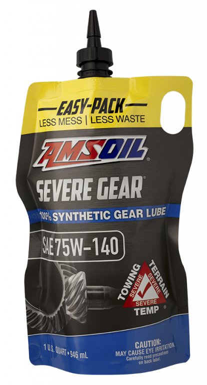

I used to run royal purple 75/140W gear lube and it dramatically helped with wear in my apex chaincase vs the normal 75/90W. Got it down to a chain every other year and fluids once per year with the thicker oil staying on the chain longer. If the amsoil is helping maybe this is more lube related? Amsoil is 75W90, that is why I went to RP it was the only one that I found that got thicker. Maybe worth a shot.
I ran Amsoil in there one season maybe two. Still wore after about 3000mi.
My amsoil is 75w/140.
