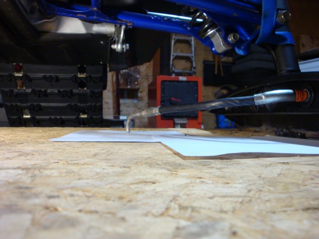

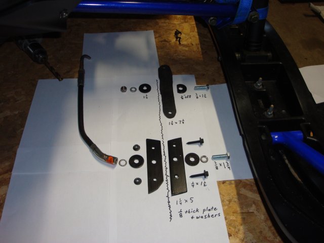

I tried searching for flex ice scratchers on skis without much luck. So here is my install, on mountain skis,
but stock skis should be similar. The 1 1/4 X 7 1/4 strap at the rear bolt, is cut from a heavier truck tire inner tube.

I had thought about doing that with my flex ice scratchers too. Last year I had them on my rail but I have a 121 so I had to have them down all the time even when I didn't need them down. Wasn't sure how I would like them on my ski's or if they would interfere with steering.

I can't imagine it would affect the steering much since they are designed to flex and it shouldn't require a lot of down pressure in most conditions, to throw up a lot of snow. But, I can't speak from experience because I have not tried them yet. Hopefully in the next couple of days, ...IF IT EVER STOPS RAINING! I'll let you know.

Scratchers will work fine on the ski with no affect on the steering. I use the spring type because they are above the ski when not in use. mounted like above they will drag in the snow when soft and are in danger of being knocked off.

I took them for a ride today. Like TBay says, you don't even know that they are there. And worked perfect!

On the rails, my 136 Attak has two wheels on each side up front, then as you head towards the back, there is not much meat to attach the scratcher to, so I've always been a little reluctant to go that route. As you get closer to the back wheels, they are obviously not as effective. On my skis, I have the older black covered Slidekicks which are 16 1/2 plus inches long. The newer Duraflex are about 12 inches long total, so they will probably position a little differently.
