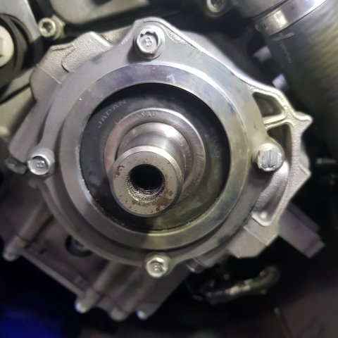

Hi guy for those who have ad this problem and put locktite between the outer race and the retainer cap did it move again after a blown belt.
It hapened last year but dealer was not aware of the bearing moving in so new fixed clutch sheave and off you go but after alignement with dave's tool and machining secondary looked good till i give her too much for the belt to old up. Seems the clutch fixed sheave as took another beating.
So how yours holding up with locktite?
So how yours holding up with locktite?Sled maniac 98

I dit the first time after a ride but this time it was a fast catch blown the bet right beside the garage so i put the new one on and went ahead the next morning to clean clutch and it was like on my picture above

Why only the one bolt?

I am thinking that the way the belt has snaped and the sheaves hit together while the motor was spining around 8900 rpm that must be just a coincidence as every thing still run true and i also did not run it for long. Just after the belt snapt i shut it down and ones the new belt was on i did not make more thant 2000 feet to the garage.Why only the one bolt?
just my thinking.
