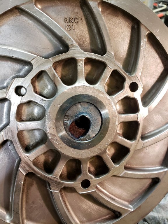

I notice that too , but not schooled enough on how to ask the question .Ummmm, why does that look like a broken stub shaft still in that drive clutch? I see where the primary has moved in and worn away at the sheave, but whats going on where the shaft is supposed to sit?
It looks like something is not parallel , as the top of the clutch appears to be worn less than the bottom .
The middle thingy is also worn less on the top than on the bottom ???

Wow, no SCHIITT!that was a hurricane stub that twisted off after 60ish miles on it

270 race... dave was really good …. stub got welded in there I guess … I couldn't press it out … sent clutch to dave … he replaced taper and inner sheave … just got clutch back yesterday

In addition to the other questions - was it rubbing the stub retaining bolts with the Hurricane stub installed? It's supposed to sit 3mm further out than stock. Yikes!I have the same thing goin on as well...here is a pic of mine..View attachment 145095 View attachment 145095

no … It was with stock stub after a couple belts broke.. stub moved in on the bearing … I was chasing the alignment and im guessing that's why … I didn't know it had moved till I took it apart to install daves stub

This could very well be one of the leading causes of reoccurring belt issues. Once one blows badly it knocks in the bearing and rubs on the bolts as well. An absolute probematic issue that we as owners should not have to re-engineer ourselves. Disgusting.

Beerman was just down and we moved his fairly easily in the press. We cleaned it up and re-assembled with 638 loctite. The part that surprises me was the fact that the part that moves is the larger outer race inside the housing assembly, I thought it would be the PTO shaft moving inside the inner race, but not the case on his.

is it even possible for the bearing to move inward … doesn't the bearing press up against the seal and the seal gets pressed up against crank case …. when the bearing holder is tighten up with the 4 bolts there is no way for it to move .. pls correct me if I am wrong ….. my issue was the stub moved inward on the race toward the engine … if I were to guess ,the race was out near 1/8 of an inch out from where it was suppose to sit .This could very well be one of the leading causes of reoccurring belt issues. Once one blows badly it knocks in the bearing and rubs on the bolts as well. An absolute probematic issue that we as owners should not have to re-engineer ourselves. Disgusting.

well I had put the green Loctite on the hurricane stub when I installed it …. when we tried to press the piece of the stub that was still in the bearing out with a 20 tonne press.. there was a lot of pressure on it to the point I was using 2 hands to pump on the press.... when it finally broke free it sounded if a bomb went off I the shop...This is very interesting. Seems like two issues from this stub. Subscribed. Is there anything else that can be done? Is green loctite going to work for the long haul?

One hard SNAP on hard accel did it for me...just once. When removing the primary, I can see a 1mm space there(outer race) where mine moved in. My offset went from NEW at 61mm to 62mm....I knew I didnt measure it wrong.lol
I would assume the splines would bottom out, not allowing the stub to move inward after 1mm or so....but its looking like more then that if sheaves end up hitting bolts. grrrr
