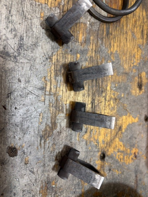

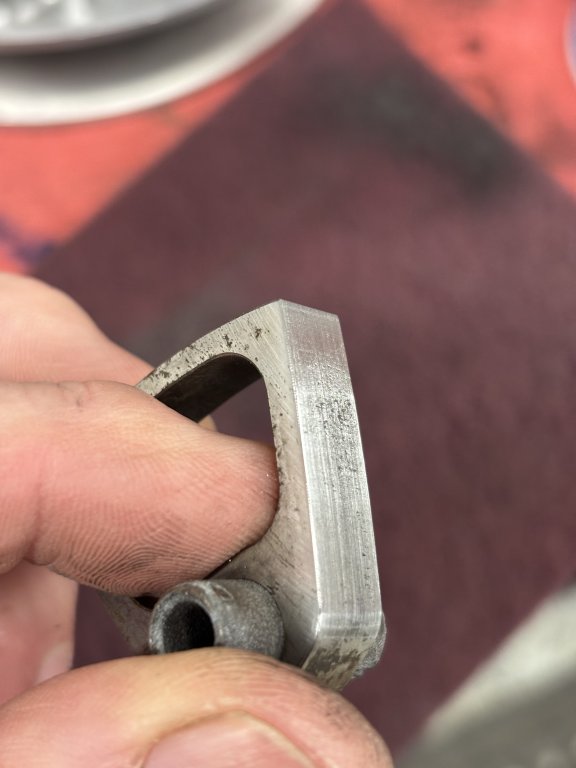

Are these marks on the ramps of my TAPP clutch anything I should worry about
Really hard to tell from the pics Rich. Is it just belt dust compressed on the ramp?

Maybe? I will try to clean them off.Really hard to tell from the pics Rich. Is it just belt dust compressed on the ramp?

Do you do alot of high speed runs at a sustained speed? Almost looks like the rollers are wearing through the hardness of the ramp due to being held at one constant speed IMO.

Not really. Some higher speed trail running, but not sustained speeds at 90 plus

Just got back from a 4 day ride.
On day 3, after 600 miles, I heard a strange noise on startup. I thought it was a suspension spring popping the ice out when I sat on it
During the ride I could tell something wasn't right, it was lazy on the bottom and getting a little belt slip also.
Luckily, I had brought 2 clutches and removed the TAPP at the hotel and rode the last day on the heelclicker clutch, which is another story.
I disassembled the TAPP this morning.
The rollers are ok. The spider buttons are worn out, the movable sheeve bushing is worn out, the ramps are starting to pancake, and the arms are a bit loose. Clutch is just plain worn out. I need to send it in for a rebuild, or maybe just buy the tools to do it myself. It's @$400 for all the tools and parts.
