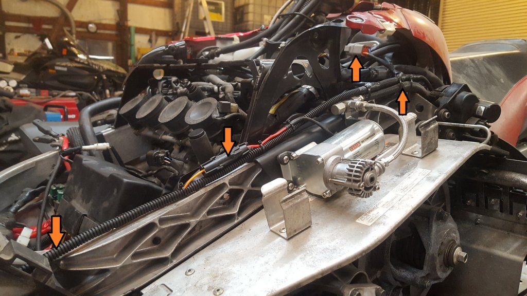

Wiring harness is complete with flex loom and zip-tied in place. Now it's time to install all the body panels.

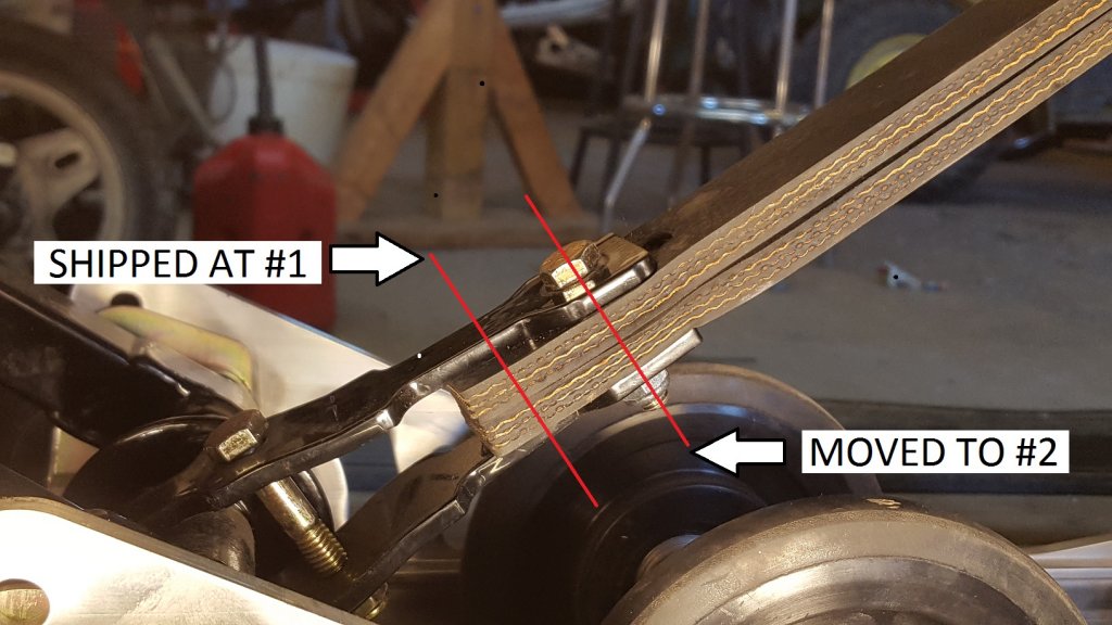

I'm finishing some final details this morning: testing HID's, spare belt relocation, snow flap and M20 decal.

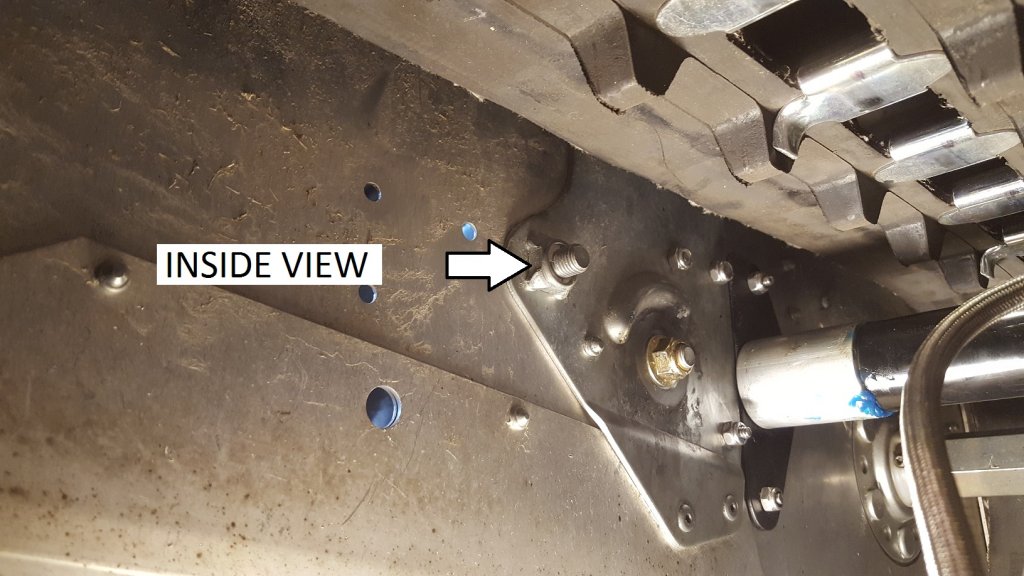

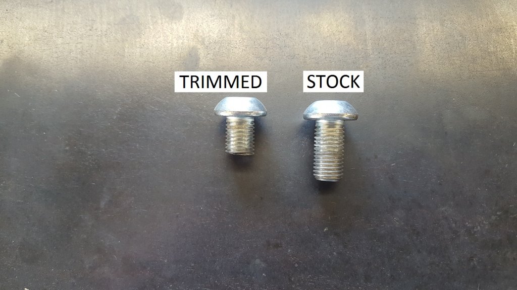

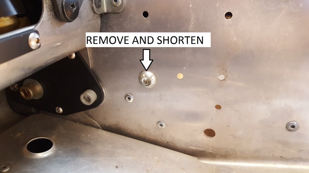

Couple of last items I just remembered:
1.) Limiter strap adjustment
2.) Additional tunnel air line clamp
3.) Stock tunnel bolt modification
There's a bolt on each side of the sled that's too long and needs shortened. Under certain conditions, the track has the potential to slap the excess threads and become frayed.
