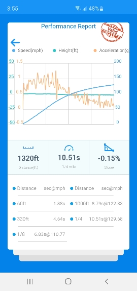

More fun on the lake today.
Removed my 120 1.575 megabites this morning and installed 96 1.325 triggers. It's a whole new animal!
I'm quite happy with how my sled is coming along. A few tips from a fast friend made a huge difference.
It was a slow day on the ice as the sun was shining and temp was -5c. I was running 126-127 consistently in 1320 on my TD 290 pump gas tune. Looking forward to some hard ice and colder Temps to hopefully realize my 130 in 1320 goal.
I now have DTYA2s loaded up to 85.29 grams with a dalton black bronze in the primary. Pulling 8900 rpms nicely now. Black orange dalton in the secondary at 70 degrees with the stock helix. 22/37 gear. I'm 220lbs with gear on.

Tried the XS belt for the first time on Friday. Conditions were good. Ran 129.77 in 1320 which was my best 1320 pass to date.
Daltons @ 82 gr
Dalton black bronze primary spring
Dalton black orange secondary gen 1 @ 70 with the Stock 35 helix.
Rpms at 89-9000
I found the XS belt very inconsistent. Like mentioned above my first pass rpms were bang on. Second pass my RPM dropped to 8400. I find that with the XS if it sucks the belt down it can't recover. I really want to work with this belt but need more time.
So I am able to run a consistent 125 mph in 1320 at trail height with trail studs. Trying to achieve 130 in 1320 on pump gas is not easy so taking advice from others I lowered the sled and replaced my megabites with 144 triggers. These changes picked up 3-4 mph and has me near my goal. This with me @220 lbs with gear.
