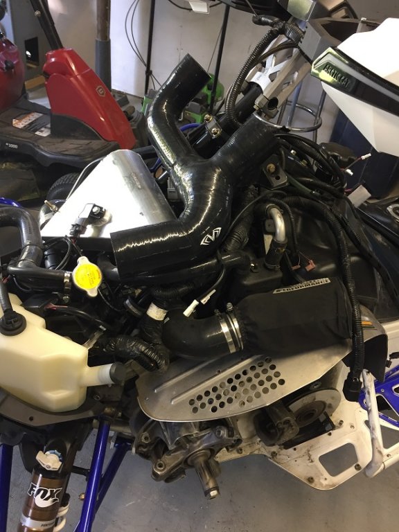

So, I checked out what I could at Hay Days. I didn't find out as much as I had like to. For sure the instrument pod that has the frogskin prefilter will fit, with the additional gauge mount bracket. But, Evo didn't have an 1100T silicon charge tube for me to look at.
I messed around with my hood on Sunday, and I think it's going to be a really tight fit for the silicon tube to clear the MPI intake. There just isn't much room in there. But I still think it's worth trying. So I'm gonna get a silicon tube from Evo first to try 'proof of concept' and that will "keep'r mooovin" for now. If that passes, I'll source the rest of the parts I'll need to make things work.

Just a quick update.... I received the cold air intake piece from Evo Powersports. Very nice piece and well made. The pics below will illustrate my idea in using this part made for the 1100T. Unfortunately, this isn't going to work. There is just too much interference. The silicon tube contacts the corner of the MPI aluminum intake. And it also comes in contact with the frame tube. The frame tube on the SR Viper is a bit different than the Cat 1100T to account for the larger 3 cylinder engine.
So, scrap that idea ... But I'm not done yet! The mock up using this intake still shows promise in the idea - enough promise that I AM going to make this work. Now on to plan B, which I think will actually work better anyway. New parts are on order. Stay tuned ....
