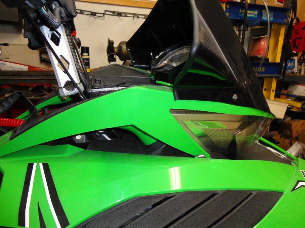

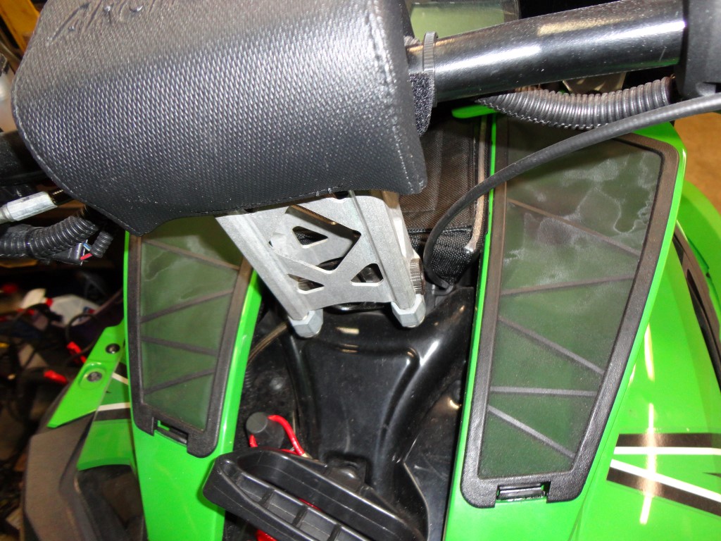

So I pretty much wrapped this project up last night (I know - ultimate slacker here.....). Gauge mounting and windshield. So here you can see what I mentioned earlier about needing to change up the gauge mount. The dash pod with the intake built in has a completely different way of mounting the gauge. So I had to use that specific gauge mount and make an adapter to accommodate the Viper gauge and my turbo gauges. Then, because of the dash pod and gauge mount, you have to switch over to using a Cat 2 stroke windshield. Of course, all of this is not needed if you use the dash pod from the 2018+ mountain Sidewinder. That sled already has the intake built into the dash pod, and is made to use our current gauge and windshield.
Just with the sled running a bit in the garage ... AFR at idle hasn't changed (will watch this closely when I get out on the trail). With running the RPM up a few times you can here more intake noise. My first impression of that isn't bad at all. Has a nice growl to it. But my perspective on that could all change once I get a chance to really ride it.
For now, I'm calling this project done.....

Turned out great!! Live and learn. Who knew they they would make that update on the Sidewinders.
Awesome! Is the guage now adjustable position like the 2 strokes? If so this is better than stock or Winder!So I pretty much wrapped this project up last night (I know - ultimate slacker here.....). Gauge mounting and windshield. So here you can see what I mentioned earlier about needing to change up the gauge mount. The dash pod with the intake built in has a completely different way of mounting the gauge. So I had to use that specific gauge mount and make an adapter to accommodate the Viper gauge and my turbo gauges. Then, because of the dash pod and gauge mount, you have to switch over to using a Cat 2 stroke windshield. Of course, all of this is not needed if you use the dash pod from the 2018+ mountain Sidewinder. That sled already has the intake built into the dash pod, and is made to use our current gauge and windshield.

Yes, the position of the gauge is adjustable. But with my turbo gauges and all the wiring associated, I can't adjust it much and I have it positioned pretty much just as stock. But if one had just the stock gauge alone (meaning no extra gauges) you could tip it back quite a bit making it way easier to see when stand up riding for boondocking and such.Awesome! Is the guage now adjustable position like the 2 strokes? If so this is better than stock or Winder!
Thats awesome! You might find at night its nice to aim it down a little so no glare and you can see better. Great Job! Now I have a project and some hope for a little more hp that hasnt been tried before. Thank You!Yes, the position of the gauge is adjustable. But with my turbo gauges and all the wiring associated, I can't adjust it much and I have it positioned pretty much just as stock. But if one had just the stock gauge alone (meaning no extra gauges) you could tip it back quite a bit making it way easier to see when stand up riding for boondocking and such.
