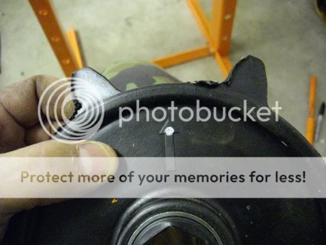

With that done, it's press-off/press-on time. A couple of things you don't want to screw up here. First, when pressing on your new drivers, be sure to use the press plates provided and press against the center collet of the driver - NOT the outside rim. Like so .....
Secondly - your new drivers should come with either an alignment arrow or some mark on each driver. Make sure those marks are each pointing in the same direction when you go to put them back on the shaft. In Avids case, he marked the teeth with a sharpie ....
Here's were the marks are on the Yamaha drivers ...
I'm using Avids CnC'd drivers. I've used them before with great results and they have an outstanding reputation. Here's a link for ya.
Now with the new drivers pressed on and aligned properly....

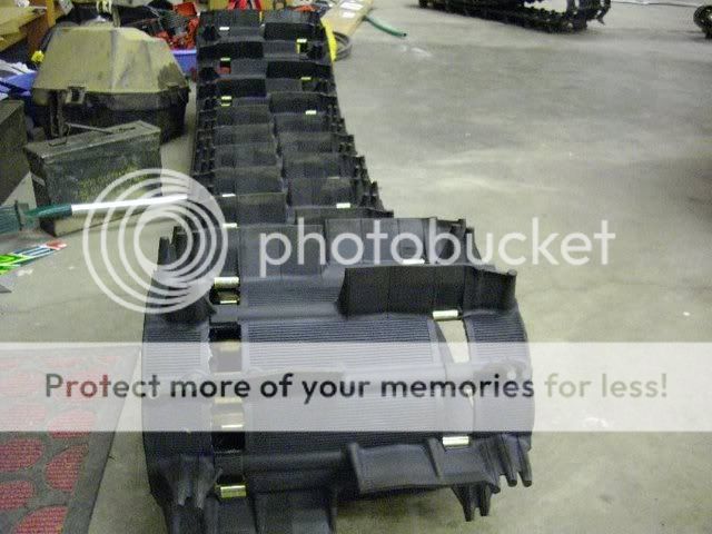

I'm going with this - new for '09 - a 162" Arctic Cat Powderclaw. This track has a reputation that precedes its coming and I'll be the 'track test dummy' for you all. It does look mean!
Anyways like every other thing I do, this track will need to be modded up. As such, there are these small nubs of rubber on the outside of each window where the driver needs to go.
So, MTDream came up with a good idea (well - kinda) by suggesting I go to Home Depot to pick up an end cutter to do the job of clipping these things off. HF however was half the price.
These end cutters almost cut the nub clean off and are more than satisfactory for this job ...

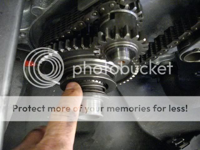

Get ready to do a little swearin' and such on this job. It's somewhat tricky but patience will prevail for those determined.
Also, on the chain case cover when I was sliding it back on the jack shaft spindle, this little seal showed itself .....
It goes in here ....
and then you slide this spacer on.
Look for this little seal when you disassemble things or you may have an oil leak.

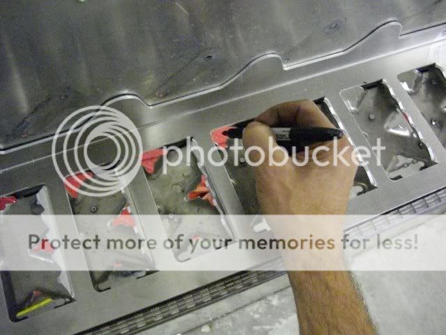

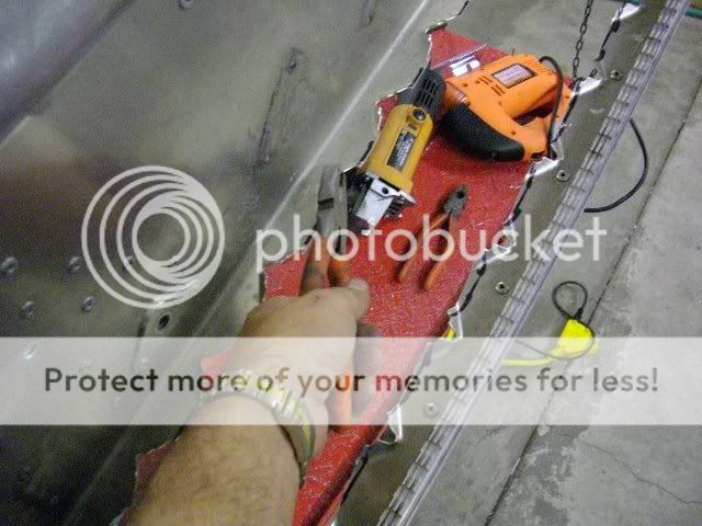

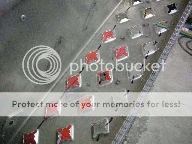

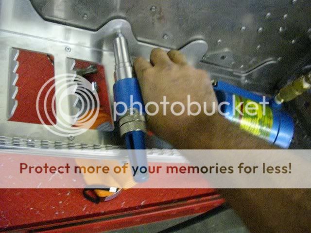

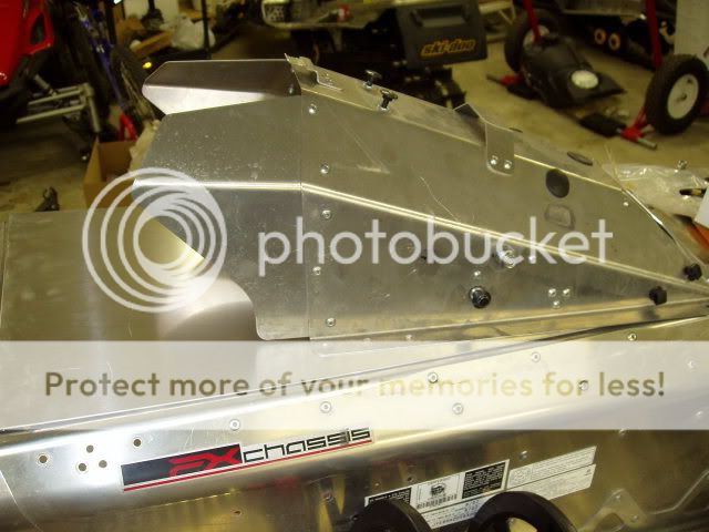

Before we move on to the suspension, lets finish up on my tunnel work of which I have two more installs to do. The first one we'll touch on are the Snow Eliminators.
These Nytros have an exceptionally poor capability of removing snow from the running boards. More than once last year I was fighting clogged footing conditions on somewhat dicey climbs and maneuvers. I'd sure hate to lose this sled cuz I lost my footing. That more than anything justified the cost for these things ....
They're not hard to install either. Start by drilling out the running board supports that are riveted to the sidewall of the tunnel. Then place the respective Snow E in place and - using a sharpie - mark an outline of the portion of your running board that needs to be cut ....
I used a $20 orange jigsaw of some brand to make the cut. Then with a pliers, I bent back flush the remaining foot grips so the Snow E will sit flush on the running board....
We also cleaned up the sharp edges with a 4" grinder. Then you fit the Snow E in place and start the drilling/rivet process ....
Now this is a much better snow removal system ....
MTDream also ran a steel rod inside the the running board support for added strength. You may want to consider doing that also to your sled (if you ride as hard as he does ...
