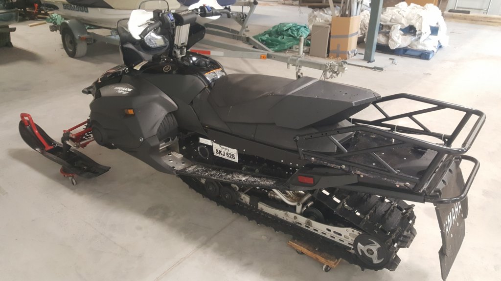

some pics of my recent nytro build after I got bored with my old vector xtx build.
What I have added:
-Magnaflow 11123 under tunnel exhaust
-Mountain Mod seat
-Yamaha mountain skis with dual Yamaha carbides
-Custom front bumper
-Oil-lite bushing kit for front end

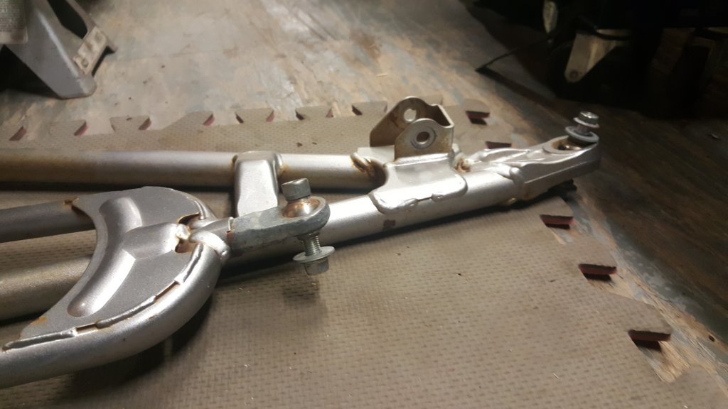

-POR-15 epoxied front a-arms and bumper
-powder coated spindles
-satin black tunnel wrap
-custom gas holder pan for 10 Liter can
-5 inch riser with throttle cable ext
- customized AC luggage rack with bag
- 12v visor plug
-1.75 back country track
- dropped 1 tooth on top gear
I hear the steering relocate kit is a must but I am still getting used to the rider forward so I think I will wait for a while yet. Any suggestions on what you think are must have mods greatly appreciated. thanks.

Great build, looking forward to seeing it in person!
You mentioned the steering relocate, I was hesitant too, (actually I saw no need until I installed the WRP seat, I'm guessing your mountaim mod seat is similar) It does make a big difference.
You addressed the skis (my opinion best improvement you can make on a nytro, and dual carbides) and upgraded the track, all great additions.
I said it before and I'll say it again, 14.5mm rollers ans a YPY spring, night and day difference. (slow speed manuverability greatly improved, a nice little performance upgrade also) I tell everyone with an XTX to do this!
Other than that its all personal taste, you have a nice build there, should suit you well.
