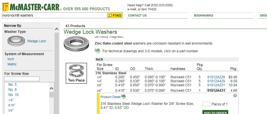

What size nordlocks do we need? Haven't even checked my turbo bolts but would be interested in installing these since it seems like it should solve the issue.
I wanted NosPro to try them to be sure but this is a Arctic Cat Flange bolt with 13mm head. Want Nordlock to have full coverage and these do. Got these at McMaster Carr years ago so no part#What size nordlocks do we need? Haven't even checked my turbo bolts but would be interested in installing these since it seems like it should solve the issue.
21mm/.825in OD
10mm/.405in ID
Here you go. These should work http://www.mcmaster.com/#91812A431
Or if you just want steel get
3/8" 0.410" 0.830" 0.090"-0.110" Rockwell C46 10 91074A331 10.06
Product Detail
Zinc-Flake-Coated Steel Wedge Lock Washer for 3/8" Screw Size, 0.41" ID, 0.83" OD
Please complete the specification for this item.
Packs of 10
Product Detail
Packs of 10
