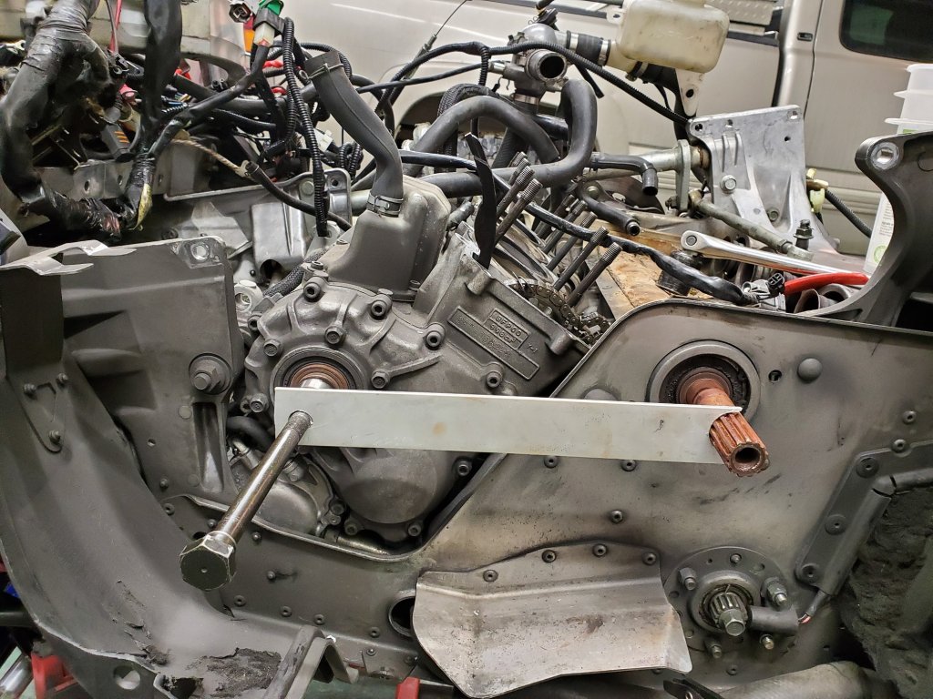

Spent a few hours after supper working on it. Made up a c to c tool tho there seems that there is no adjustment in the motor mounts to change this.
- 5,722
- 4,312
The only way I've ever been able to tweak engine alignment is by using the threaded adjusters in the frame on the front two mounts. Yamaha never recomended moving the engine this way, however.Spent a few hours after super working on it. Made up a c to c tool tho there seems that there is no adjustment in the motor mounts to change this.
View attachment 152890 View attachment 152891 View attachment 152892
I would thread the right in, and the left out to push the front of the engine over if it needed to be.

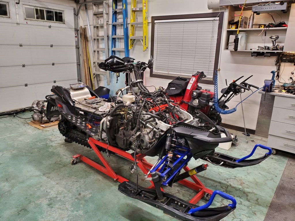

Nice workspace set up. Definitely helps to have the right tools!

For alignment I always left the front loose then used the rear bolt adjustment over by the chaincase side. Set your offset and alignment then tighten the front down. Your jig idea is not bad either! Attached is service manual way.
