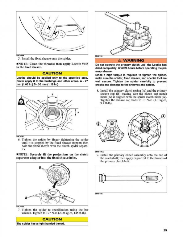

ClutchMaster, is the primary clutch bolt a torque-to-yield bolt that has to be replaced each use? If it stretches, doesn't it have to be replaced? I asked that question a month or two ago, and now that I literally sheared a primary clutch bolt off when my last belt blew, I'm wondering if these are one-use torque-to-yield bolts. I don't think they are because the service manual doesn't say it, and tons of guys re-use the bolts. I think my issue was (stupidly) putting a light film of oil on the stub shaft the last time I installed the TAPP clutch, causing a failure.
Nevertheless, I think the service manual says put engine oil on the primary clutch bolt. Have you ever had any issues with loctite and not oil? The thumbnail below is the relevant page from the service manual.

No, It is not a bolt that needs replaced each time.
Not to speak for Clutchmaster, but I think he's confused on putting loctite on the main clutch bolt. It should be oil used to TQ down just like the manual says.
loctite gets used on the roller bolts and nuts along with the weight bolt and nuts.

well I’m the cat 9000 manual it’s a much different procedure. Torque to 51 ft/lbs, start and run engine then retorque to 51 ft/lbs.
I found that 100 ft/lbs with lube on the threads seemed excessive so I actually do 95 ft/lbs with loctight then loosen and then back to 50 ft/lbs.
no issues. I did the lubrication on the threads and yamaha torque specs, clutch wouldn’t come off with my puller. I felt as is the dam bolt was going to snap so I modified my installation process.
9000 manual process, as you can see the writing in red shows they no longer recommend using oil on the bolt threads.
