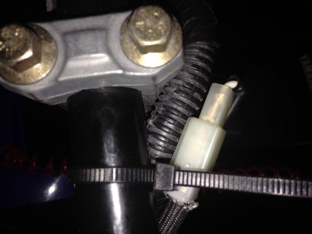

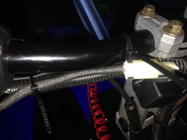

When you route the adapter and warmer wires make sure there is play at throttle since when throttle is pushed it pulls the wire. Here is how I did mine. Notice zip tie goes through tang on plug. Not on the bare wires.
Remember the zip tie on cable adjuster is NOT tight. Leave it loose so cable can move.
The Phazer pad doesn't cover everything now but still looks better to me than stocker plastic which does still fit and covers it all. Will probably use some electrical tape on the white plug for looks. But here it is.
