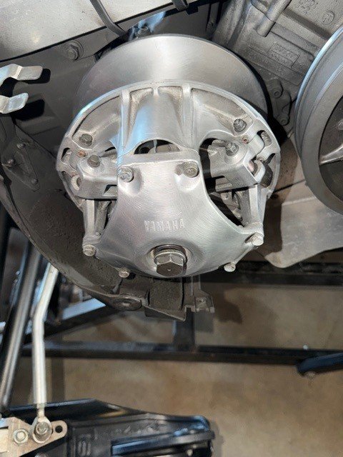

The one I picked up from Travis cleaned up nicely. Sure, I would've preferred there was no oxidation on the clutch but after all, it is called Barn of Parts:

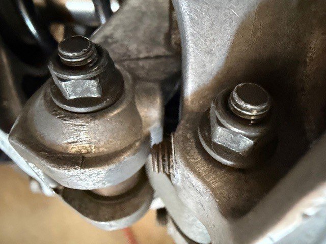

Looks mint! But that tie rod don't! Just breathe.....The one I picked up from Travis cleaned up nicely. Sure, I would've preferred there was no oxidation on the clutch but after all, it is called Barn of Parts:

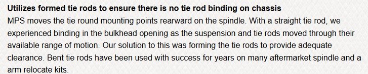

That's because that Apex (ie. non-EPS) has BOP's MPS kit which comes with bent tie rods. I believe it was Knapp that mentioned when he ran the MPS kit, he did not use the bent tie rods.Looks mint! But that tie rod don't! Just breathe.....

You only need the bent tie rod if you use hole 3 (the one farthest out). Other 2 holes you can use the stock tie rods.

We're sort of digressing here from the OP but I really appreciate you passing along that info as I did not realize and as you can see, am only using the first hole as I thought just that little difference made a huge difference.You only need the bent tie rod if you use hole 3 (the one farthest out). Other 2 holes you can use the stock tie rods.

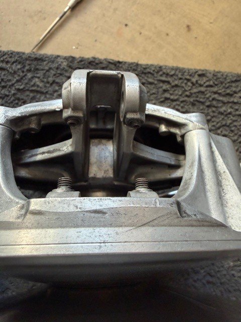

One thing you will find as I suspect these older primaries with the set screws for the rollers AND the clutch weight will be hard to come by, is that the primary may not have the roller set screws but will have them for the clutch weights. This is the original primary I am replacing where the moveable sheeve cracked; will keep since the spider is good:Yes, no problem finding them. Going to take a peek at another one on Sunday.
I suppose I can be picky as I have all kinds of time.
If the primary you are looking at is still loaded (ie. weights, springs, etc), the roller set screws may be hard to see but should be visible; or lack thereof:
