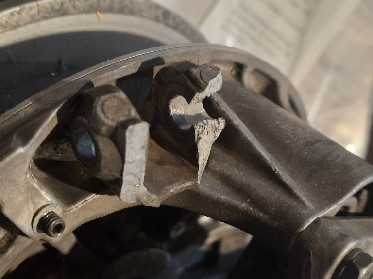

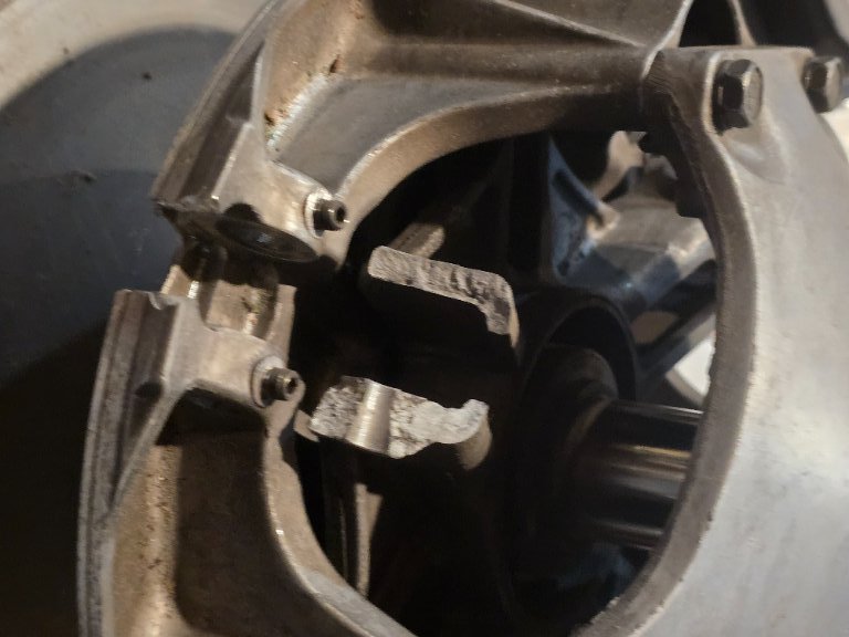

Here is a couple pics of the last spider that broke on the nytro.

Looks like the damage was as caused by a weight malfunction?
- 5,722
- 4,313
The ones I have seen and witnessed cracked from the inside out. Where the aluminum molds to the steel.
I don't have any pics, this was many years ago.
I recall asking my dealer if he had ever seen this happen, he said a few, but it's a rare occurance.
The first sign is the machine will rev much higher as the crack causes the spider to bind.

The weight and roller were fine. They went into the next clutch and am still running them today.Looks like the damage was as caused by a weight malfunction?
- 5,722
- 4,313
Ok, so not seen in the pic is that there's a crack that started down lower on the spider and made its way up to the roller?The weight and roller were fine. They went into the next clutch and am still running them today.
This is what mine did also.
Yes
That Nytro had the 5 year YES warranty on it. I exceeded the price of the sled in warranty claims and the YES warranty became void when that happened.
When the clutches would get dirty the 8dn belt would slip on top end and create heat in the clutch. I had to clean the faces on clutch every 300 miles otherwise rpm's would climb up and hit rev limiter.
Belt life was around 2000 miles.

I've never seen a spider break like this before, thats crazy. I doubt highly its heat related as its not connected to the sheaves in any way and gets plenty of cooling from windage.
I've run my 1000 mile RX-1 primary for many miles on 300+ HP Winder for a few seasons prior to going to the TAPP I ran without any issues. Also have run the Yamaha primaries on turbo RX-1 and Apex for many miles. Guys have even run the Yamaha primaries on turbo 1200 Doos which were extremely hard on clutches and I've never seen such a thing. Don't know how a low HP Nytro, could break this spider, just doesn't make sense to me. Typically heat would crack the sheaves down at the post area from engagement and slipping down low like the Cat TEAM primary would see.
Seems to me the movable must have been binding and caused the spider to lock up and snap the tip of the arm off when the weight swung. Just a thought.
