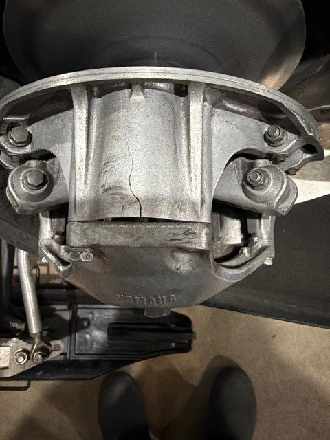

Obviously, you'll want to inspect for cracks like this as well as check the sheave faces to ensure there are no worn grooves and cracks; especially around the center of the sheaves:

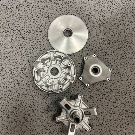

As for the replacement, unless it was recently used and not stored, it will have some oxidation. Here's the one I picked up from Travis. Will get it cleaned up but it is solid and the sheave faces are smooth and flat. The unknow is the inner bushings that can only be inspected via disassembling the two primary sheaves:

Good tips, Rob...I'll grab a straight edge for the sleeve faces!Obviously, you'll want to inspect for cracks like this as well as check the sheave faces to ensure there are no worn grooves and cracks; especially around the center of the sheaves:
I'm assuming the inner bushing you speak of is a wear item. What would be considered a low mileage primary for that bushing to not be a concern?

Spider has been know to crack from spring pocket out towards roller if clutches were over heated from belt slippage.

Are you saying to remove the cover, pull the spring to verify??Spider has been know to crack from spring pocket out towards roller if clutches were over heated from belt slippage.

Never heard of a spiders cracking, thats a new one to me and not sure how that could even happen, but certainly down low on the sheaves for cracks from heat. Also buttons being tight on the towers, but certainly groves being worn on the faces. Bushings are going to need clearance for movement, but if the clutch looks good on the faces it should be a decent enough low mileage clutch.

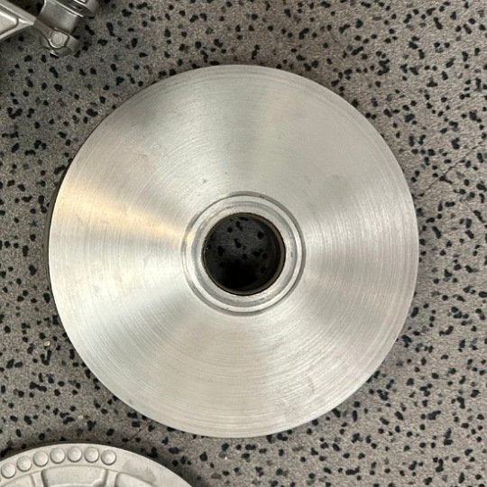

Perhaps pic will help. Groove towards the center. Is that going to be a problem? I assume so?!?!
*just recieved pic
*just recieved pic

looks pretty good. i usually crack mine within an inch of the hole. that groove is normal on all my clutches.

Oh, no way!! Lol. I just read a post (Knapp) in regards to grooves and thought for sure, that groove would apply?!?!looks pretty good. i usually crack mine within an inch of the hole. that groove is normal on all my clutches.
Is it just too low in the sheave to matter? Idk...otherwise and without verifying sheave for any low spots, they look ready to go.
*just recieved pic
If they have many miles at all, they will always get a little engagement grove in them, that is normal, you are engaging on a belt that is not moving after all.
Other areas on the face are from spending too much time at certain speeds for too long.

Okie dokie. I guess I'll just run a straight edge on them. Are little gaps to be expected when checking sheaves?If they have many miles at all, they will always get a little engagement grove in them, that is normal, you are engaging on a belt that is not moving after all.

Right, I've seen a few do this. Had this happen on the Nytro I used to own. It started over revving then the roller arm broke right off.Spider has been know to crack from spring pocket out towards roller if clutches were over heated from belt slippage.
When running an 8DN belt[hard like steel] you will develop a groove down low on the primary. The higher the engagement the sled is set up for the more the groove develops...kind of normal on most yamaha primaries.If they have many miles at all, they will always get a little engagement grove in them, that is normal, you are engaging on a belt that is not moving after all.
