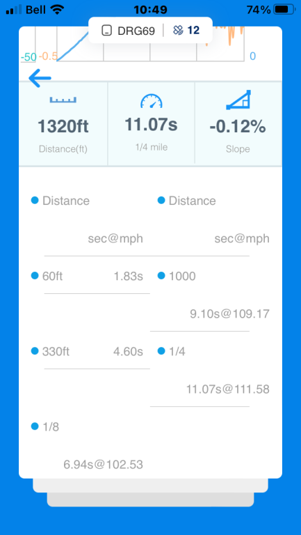

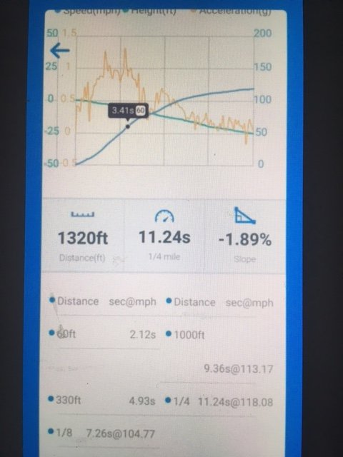

rev them up's dragy post and the one I posted[sideshowBob] make an awesome example of faster is not necessarily quicker.
Both our sleds at the time the dragy runs were recorded sound to be very similar in tunes and mufflers.
I run a 1.75" x 141 track rev them up runs a 1.5" track that I assume is a 137"?
Bob's run
rev them up's run
rev them up's sled out mph Bobs sled at all distances...Bob's sled was quicker at every interval
Bob wins the drag race but rev them up wins the radar run
LOL...its all in the setup and intended result
rev them up would have been catching Bob's sled big time at the 1/4 mile interval.

100% agree... This is a perfect example. for radar runs I'd take the quicker sled every time.rev them up's dragy post and the one I posted[sideshowBob] make an awesome example of faster is not necessarily quicker.
Bob's run
rev them up's run
But for lake racing off an arm drop, I'd probably prefer the speed.
An arm drop has a variable of .5 of a second, and no one would ever know. Then on top of that the distance is not exactly official.
Crazy to say this, but this example would be a dead heat until the very end.
If the guy dropping the arm even flinches, I'm out.
Usually you'll see their legs start to bend just B4 their arms start to drop.
If you are watching others race B4 you, watch the guys body posture and what he does just before he releases. Lol. Truth

Very good explanation for the guys who think mph wins drag races, et does, not mph. PPl look at mph to much. i'll be interested to see mine this year since i made major changes since that run, 3mm taken off secondary( locked down secondary), got rid of d the ggb can(came on sled, would never buy that) added 3inch stock mod, fuel filter was plugged to the point it would barley beat my nytro(but not throw lights) added the big pump went to ms17 lean, added 39/35 vs the stock helix and trying the black/tan secondary spring and the gates belt.rev them up's dragy post and the one I posted[sideshowBob] make an awesome example of faster is not necessarily quicker.
Bob's run
rev them up's run
After many different mufflers, I have been using the TD 3" stock muffler mod for a few seasons now with a header and it is by far the best compromise or maybe better stated balance for performance and noise I have found.Here is one of the very first runs i made. on snow, not great but a GOOD track, 1.5 lug , very easy start with a garbage muffler ggb, have since went to a td 3inch stock mod and better clutching but have not ran it since making the changes, had to add 2 grams to bring rpm back in check when i switched mufflers. MS17, running MS17 Lean this winter.

Just run MS17 or MS20 and forget about the rest.Solid for a 1.5" track. You'll be north of those numbers this year.
