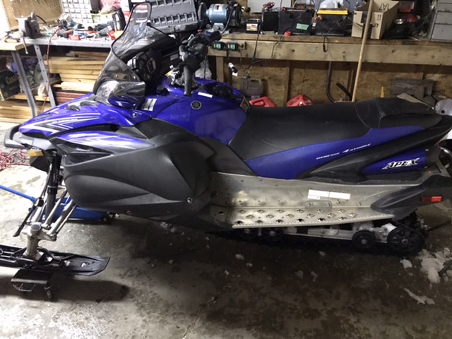

Last weekend we headed up again. Got a call from the guy we bought the Apex from and he was heading to Minocqua so we set up a meet in Merrill on Saturday morning at 7am to get the air shock that came in from being rebuilt.
Saturday morning after getting the shock, we put it on the Apex and set pressure to 195PSI then loaded the 2 Vipers and the Apex in trailer. This was just us guys this weekend. No anchors (kids or women).

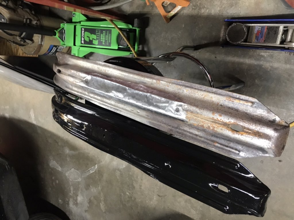

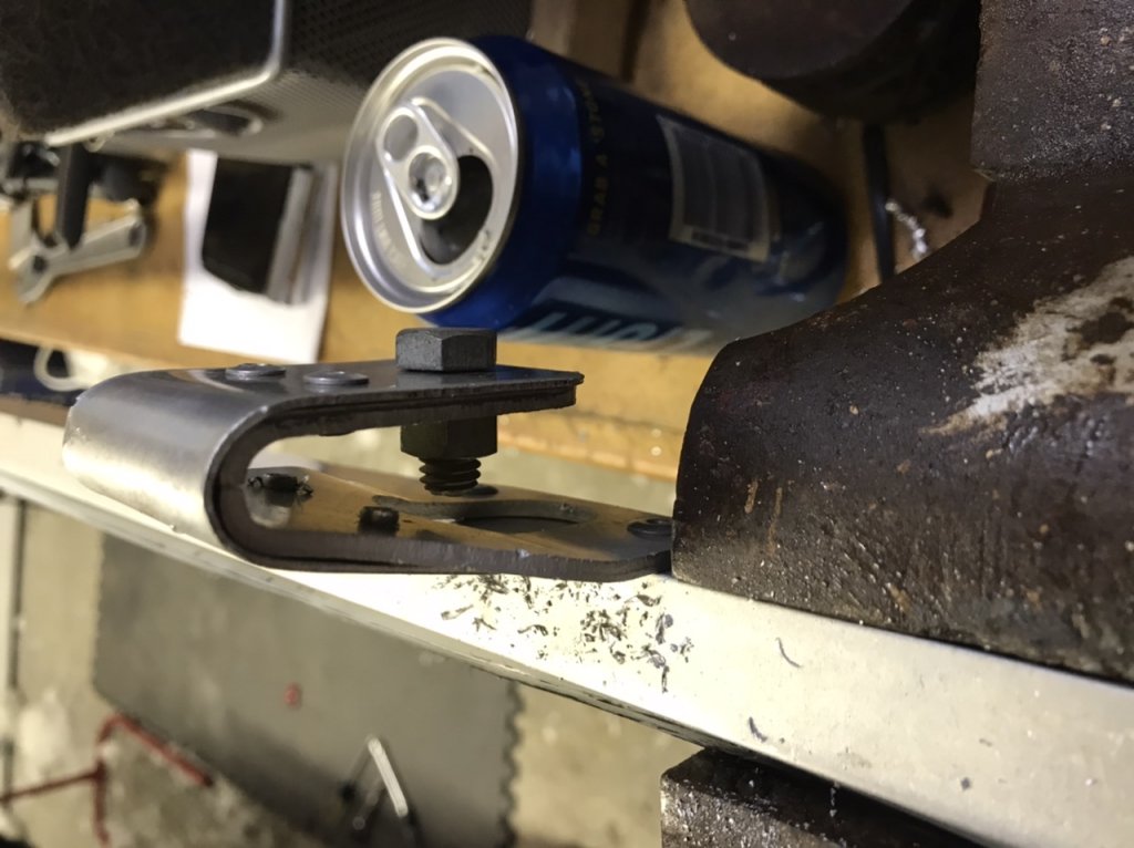

Also before I left I wanted to put some new wear bars on my sons sled so it’s that much closer to being ready when we go up next time. Still need to put his skid back together and install it before he can ride it. Push comes to shove, he rides my dads SXR again. But I noticed the metal skis on this 1990 Arctic Cat Jag AFS are rusted and split. Well, #*$&@!! I had to pull them off and bring them home for repair or replacement. New skis are $140 each. Plastic skis are $260 pair but I paid $100 for this sled so I’m just gonna repair what we have.
Removed wear bar. And I say wear bar because there are no carbides on these bars. Then cut out the bad section.

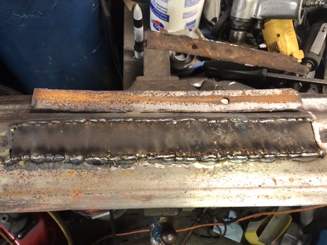

Used a piece of 14ga steel and cut to shape and tacked in.
Welded it completely and then ground it down. Still need to clean it up a little more and then I’ll blast them before paint.
Second ski I thought was the better one but it wasn’t. Previous owner welded a patch on so I had to cut that off first and then cut out bad part of ski. They patched right over the rusty ski! Some more tweeking to do but it’s almost complete.
I’ll show finished product when it’s done.

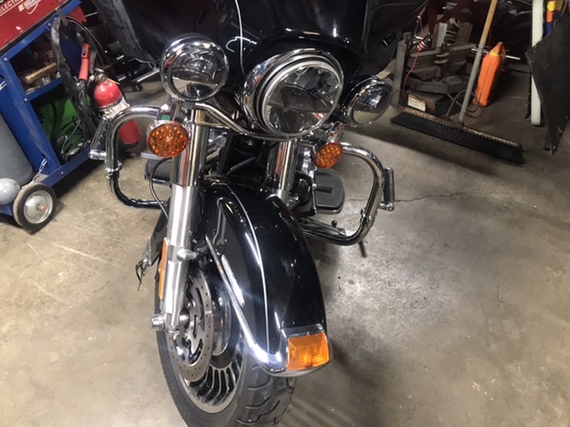

In the meantime, I splurged again. My buddy told me about a sweetheart deal on a Harley that I couldn’t pass up. I already have a Fatboy but my wife wanted me to get a streetglide last year but I didn’t find one I wanted. This bike is a ‘13 Ultra Classic Limited 110th anniversary with 13k miles. It’s black, what I really didn’t want, but I spent a lot of time on my buddy’s Ultra this past summer and the wife loves it so I pulled the trigger. All I can say, it’s a nice bike, but I need a bigger garage.
I already removed the lower fairings, I hate them because my big feet get caught on em.
I ordered a new inner cowling to put a double din head unit in so I can have touch screen with navigation. They came out that way in 14 but they also added liquid cooled heads and radiator is in lower fairings so it can’t be removed. This being a 13, it’s easy to add a new stereo.
New extended bags on their way, and so is fender extensions with lights to get rid of rear light bar and have lights between fender and bags. Bike already has V&H exhaust system and tuner. Sounds great!! Just something to eat more of my money!!

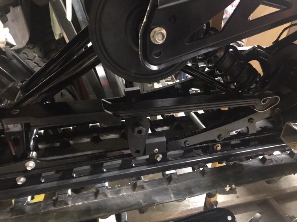

To bring this up to date real quick, I think I left off when I was fixing my son’s skis on his 440 AC Jag. They came out really nice and performed as new. Said he could steer a lot better with the new wear bars but wished he was still riding the SXR. Lol.
I also rebuilt his entire skid with new bushings, bearings and all new hardware. Simplest skid ever. I even threw on new hyfaxes. The bearings I removed the seals and packed them with Amsoil grease before installing. I couldn’t source new springs or shock so I just reused them but cranked on the springs because this thing has little to no suspension. But I figure, I started out on a ‘76 Arctic Cat Puma so he’s riding a Cadillac compared to what I had.

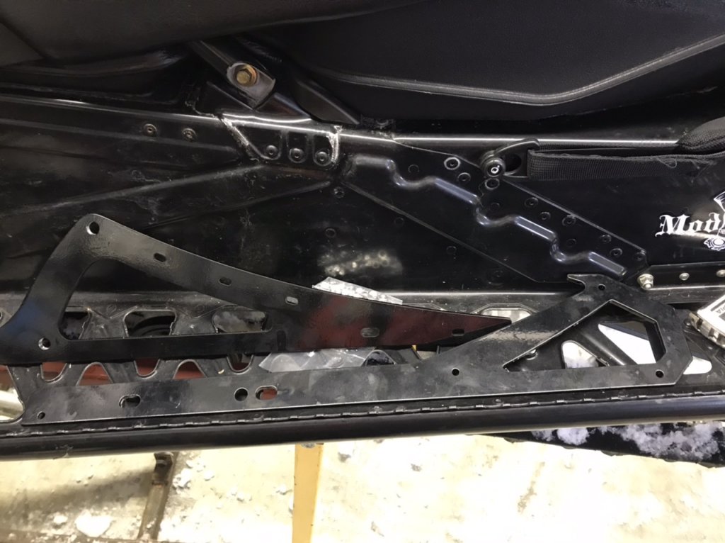

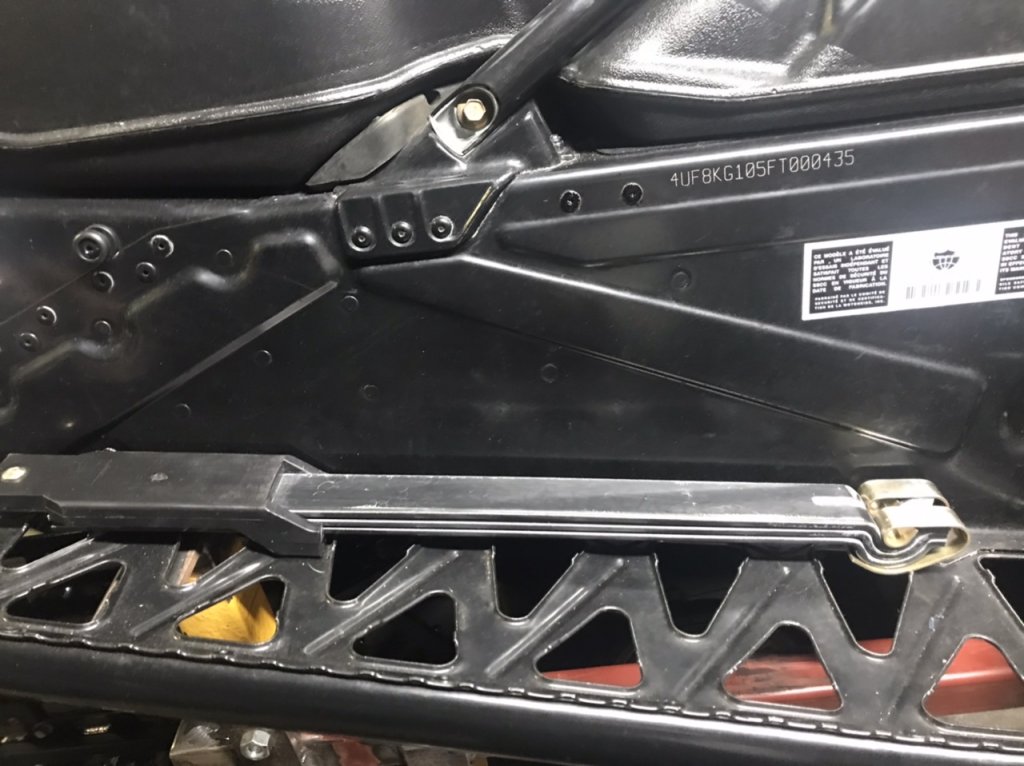

I picked up a set of rail stiffening plates and so far put the rear plates on.
I wanted to put the front plates on but it would have required me to remove crossshaft and there was still snow on the ground so I figured that will have to wait. I need to modify front plate also because I’m installing overload springs but it’s gonna take some fab work to make it happen. The overload are designed to slip down over the rail and will need the slot opened up longer to make it work with this 153”. I don’t want to widen the slot because it would be a lot less meat on the sides and probably break. With the addition of a plate on outside of rail, it would need to be slotted more on outside. Just seemed like a recipe for disaster. So I’m gonna make my own plate for around the overload spring and it’ll have to be cut out around the spring. It’s in the works and I’ll share when I get there.
That weekend was another good one. New sway bar end links proved to hold up. And I tried to break them. But I did find an issue with the Apex. It’s got 2 tunnel protectors that run down the inside of the tunnel and they are suspended from the tunnel. 2 of the 3 brackets were broke and it was riding on the track. So we had to pull it out and do a quick bush fix to it until we can get the parts ordered.
Just riveted some aluminum from my factory skid plate to piece the brackets together. It worked.

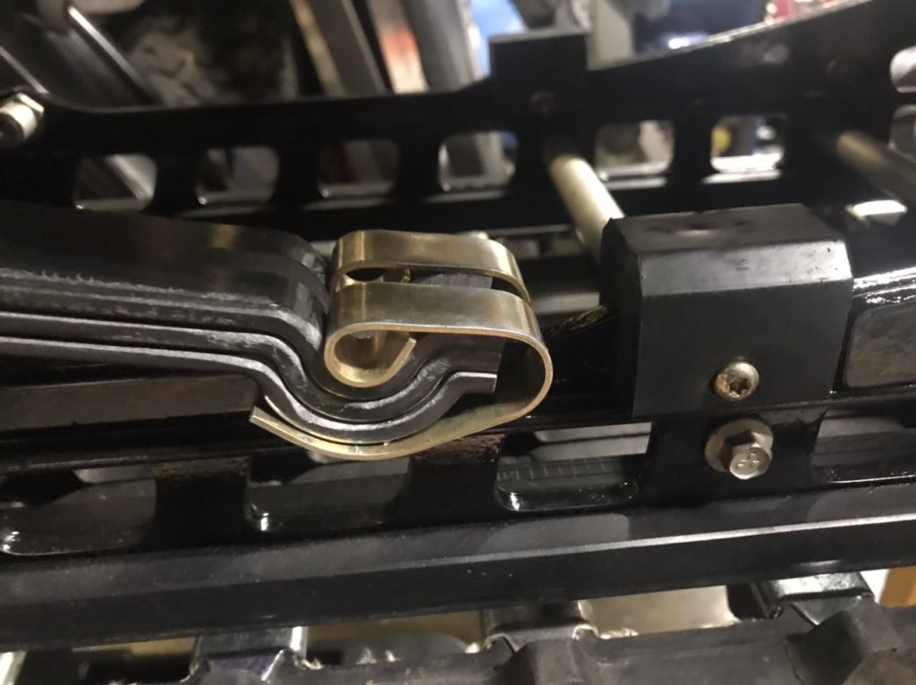

Rail stiffener plates are finally on. I had to slightly open the holes in new plates due to powder coat because hardware didn’t want to go in.

Next issue was with the 1/4 J-hooks that I installed to hold up my ice scratchers and keep them off my skid plate. My scratchers are thicker than the ones on my brothers sled and were bending the J-hooks I put on. So I ended up drilling and tapping to a 5/16” and installed new J-hooks with a tall nut on outside and locknut on the inside, just as I had with my 1/4” hooks. This should hold better.
While I was cleaning sled I noticed the sand and small rocks that built up between the tunnel and bumper rail that runs down the side. I tried using a blow gun to get the debris out but no luck. It was wedged in. So I ended up putting a piece of tape on screwdriver.
Wedged it between rail and tunnel and pried on it slightly to open the gap and the blow gun was able to blow all the debris out of the channel. Had to work it down as I went but I got it clean.
After I had it cleaned out and cleaned sled, I decided to run a bead of black weatherstripping adhesive down along that seam to keep this from happening again.
