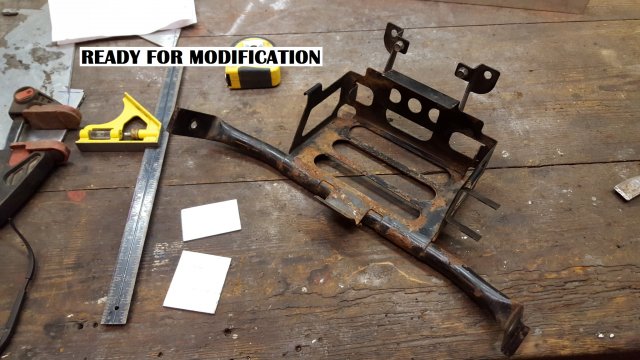

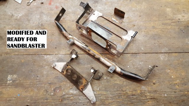

That is a sweet idea. I may try that next year when I'm doing my yearly maintenance. Plus it will give me an excuse to play with my new wire feed welder a little. :)

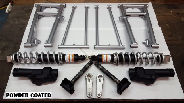

PHASE TWO - THE FRONT

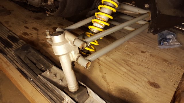

OK...back to business! The aftermarket A-arms on this sled have been bugging me from day one, so I'm upgrading the entire front end to greasable arms and shorter spindles. These parts all came out of my spare Vector LTX stock. I'm also replacing the front shocks with very low mile shocks that came off my 2012 Apex XTX.
Stay tuned...I'll post more pics as I get the front end work complete! I hope everyone had a nice Christmas! ;)!
