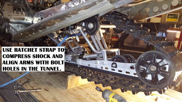

I forgot to add this to my earlier post...
I always struggle with removing / reattaching the throttle cable at the carburetors. It's hard, for me at least, to hold the throttle linkage wide open while trying to get the cable in place.
I used a flat screwdriver to open the throttle, then placed a piece of key stock under the cable guide to hold the throttle wide open. (sled not running) The front airbox rubber is what keeps key stock in place and leveraged against the throttle spring. This worked and freed-up both hands to get the throttle cable installed!

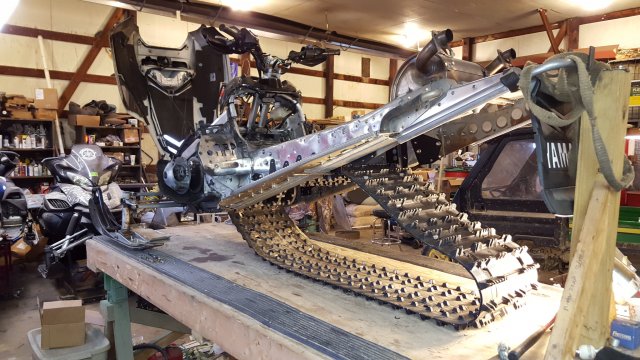

I did a similar mod to my Warrior this spring. I installed a 07 Attak skid in mine. I can't wait to try it out to see the difference. I also had Cannondale27 rebuild all the shocks. It should feel like a new machine now.

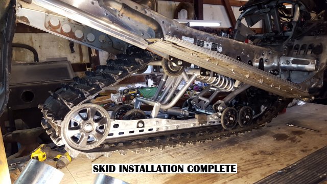

I’m curious to know if the front mounting hole was the same from both skids. I wanted to put the apex skid in my 03 RX1

No. The Pro Action and mono skids have different mounting locations.I’m curious to know if the front mounting hole was the same from both skids. I wanted to put the apex skid in my 03 RX1
Travis, at Barn of Parts, sells a mono retrofit kit to adapt a mono into your sled. That's what I bought to locate the mono into my Warrior.
