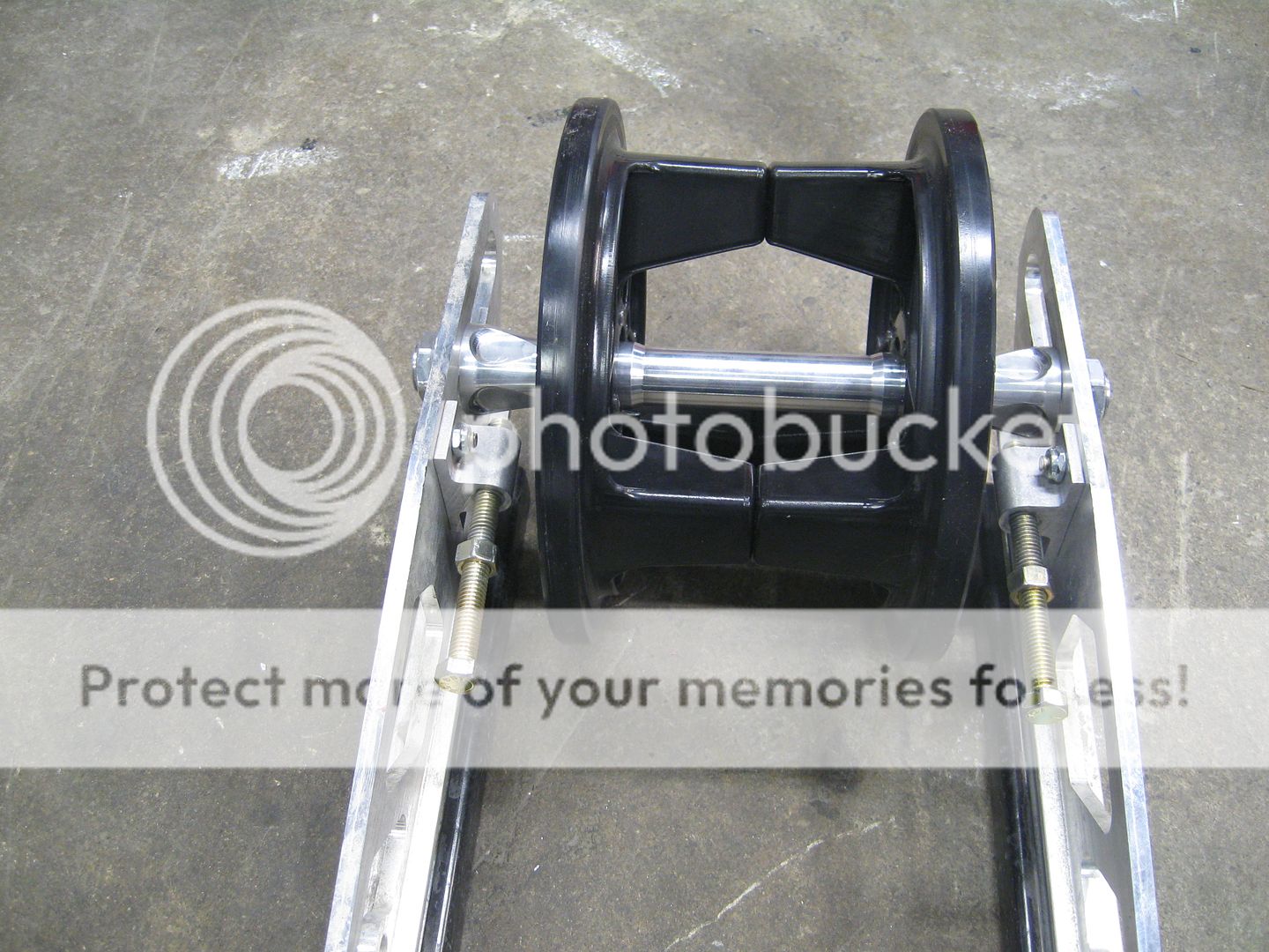

Got the cat wheels today and everything mounted up. Not as nice as the OFT wheels but a heck of a lot lighter. The wheels seem pretty strong being bolted together but only time will tell if they hold up. I'm also anxious to see how much ice and snow they hold.
OFT axle with both wheels and mount bolts is 4 lbs 4 oz.
Ice Age axle with both cat wheels and the alu end nut is 2 lbs 7 ounces
Almost a 2 pound savings.

A friend of mine had a look at a Summit rear axle and wheel. He said they are also two wheels but somehow joined together by a large diameter pipe. This sounds like it wouldn't fill up with snow.

Ive got about 200 miles on it now and everything seems fine. No bends or cracks in the subframe or diecast(yet), engine mounts are still together, turbo hanger isn't cracked. Today was deep with a lot of downhill carving and it goes through the snow just as good as it did with front plastic. I wasn't sure how the open front was going to work but it doesn't hinder deep snow performance at all and there's no place for snow to build up. My RPM's are low, around 8,200 and I have some belt slippage up high but that can be fixed.
One thing I'll probably do this summer is drill out all the cherry max rivets and powdercoat the tunnel skin. It's not going to be an easy job but the bare aluminum holds snow and builds up ice like crazy. I might have to try a few spray on products and see if I can find something that will work good enough to keep from having to powdercoat.
