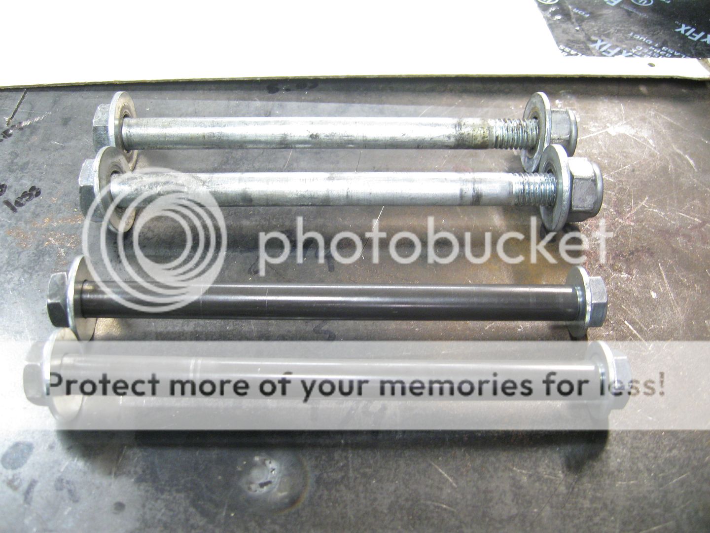

I made ski bolts today. Before I got too carried away I cut a piece of 3/8" .058, installed it with a vice grip on each side, and then rocked the sled side to side maybe 25-30 times continuously slamming the 4130 side down to the garage floor trying to bend it. I'm confident the tube will be strong enough, but wanted to do a quick test. Only time will tell now.
For the tube bolts I started with 3/8" .058 4130. I then drilled out a couple thin 3/8" jam nuts to fit over the tubes and fused them together.
I wanted to stick with standard hardware, but using a 5/16" bolt would have required drilling the end of the tube out to 9/32 before tapping, so I went with 8mmx1.25 bolts which only required drilling to 17/64. Tapped the ends only deep enough to thread a 8mmx1.25x12 bolt. Here's the new hardware 100% done.
New hardware in front of the old bolts which I had previously cut down to be flush with the nut.
Both tock 10mm ski bolts (which had been cut to 140mm) with nuts and washers were .55 lbs
My new tube bolts complete are only .29 lbs for both
Total weight loss of .26 lbs which I think is pretty good considering it's only from two new bolts. As with all the parts I'm making, I'll be sure to post if they fail out on the snow.
