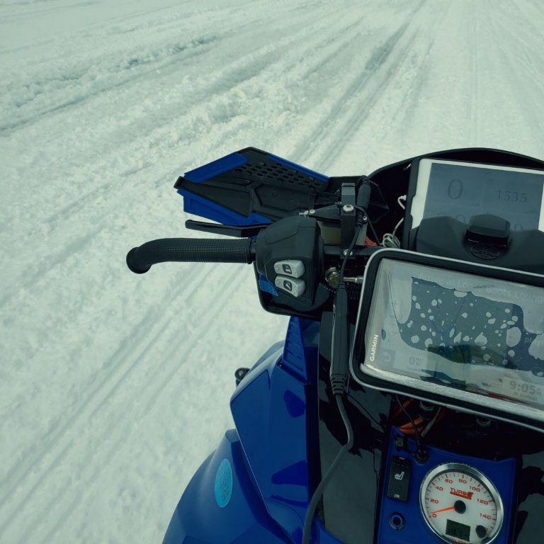

I like how you mounted the TD gauge Fatchance. Good idea!Works the nuts installed here Terry
