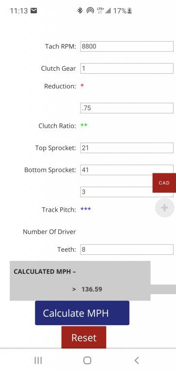

Was looking at my datalogger and my rpms were rising fast after 137mph.
I am definitely out of gear now and I can't machine my stock clutches anymore.

No studs ???Was looking at my datalogger and my rpms were rising fast after 137mph.

View attachment 160453 Impressive! You must be running well into overdrive?
Yes, I took out .035" each side of my primary and trimmed down the hub on my secondary. The belt was polishing the center...LOL
