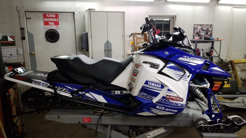

Friday night the SW was switched from trail to asphalt in a matter of 5 hours, start to finish.
