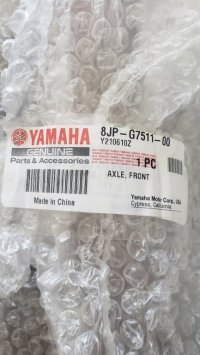

I believe "shaft only" is discontinued, complete shaft assemblys are avalible, just picked up one a couple weeks ago, lucky i have cat and yammy in same building, big price diff between the two, cat was about 470.00 and yammy otd for me was 332.00....shop around in these times of greed!!Tried bearing mount Green.. No go as the gap was to large. Turned it into powder after some miles. This is a 2021 8000 cat that the shaft was worn @ 180 miles from brand new from factory. I ran the sled for one trip without a wedge and its been garbage since. I looked up a new shaft a few months ago and it was "no longer available" NOT back ordered. ???

Good to know thanks.. Full assembly meaning the shaft and the drivers correct?I believe "shaft only" is discontinued, complete shaft assemblys are avalible, just picked up one a couple weeks ago, lucky i have cat and yammy in same building, big price diff between the two, cat was about 470.00 and yammy otd for me was 332.00....shop around in these times of greed!!

Yes, drivers and 3 bolt gasket flange included, took mine straight to machine shop for a bearing retaining pin and grove in a new bearing.Good to know thanks.. Full assembly meaning the shaft and the drivers correct?

I got the shaft only Partzilla on April 13.I believe "shaft only" is discontinued, complete shaft assemblys are avalible, just picked up one a couple weeks ago, lucky i have cat and yammy in same building, big price diff between the two, cat was about 470.00 and yammy otd for me was 332.00....shop around in these times of greed!!

Those ordering new shafts.....how do you know you are getting the updated shaft? I don' think there was a new part number for 22 "hardened" shafts. I plan to do a file test with my 22 and see if it appears harder and look for any physical change that one can detect by eye to differentiate.
