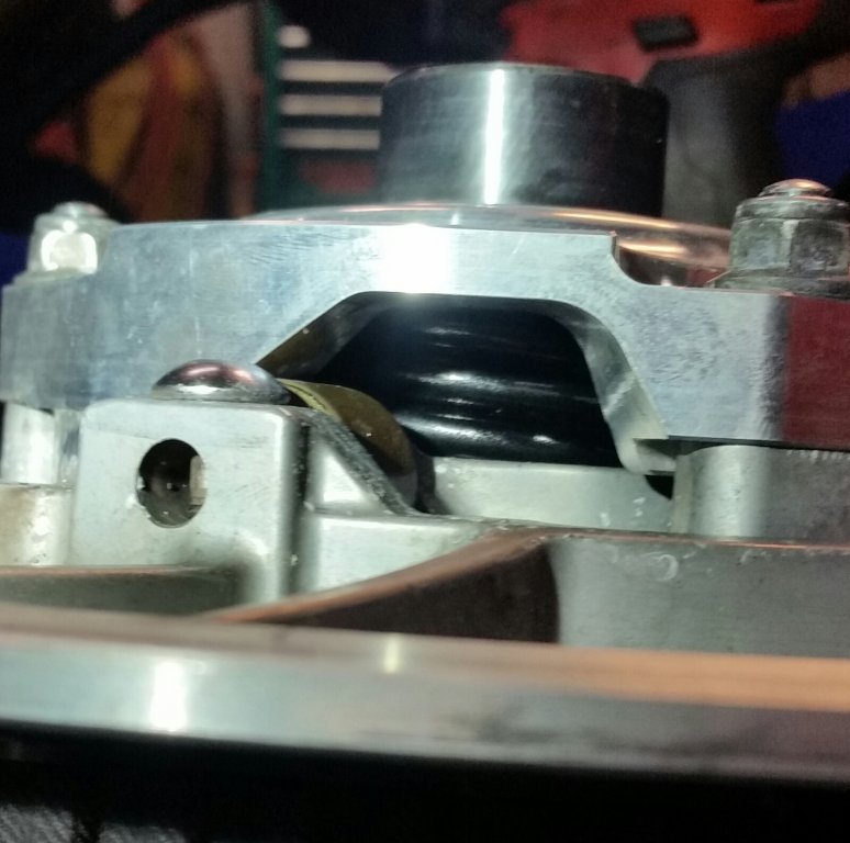

8dn or 8jp doesn't matter when they coil bind this bad. This was as far as mine would shift out with .070 cut out of my spring pocket. I can't believe this made production. Been testing with other secondary springs so far without more blown belts.

So far I've had good luck with the Hauck red. Works similar to stock but does not coil bind. The wrap is different. 3 and 9 is about 60 deg. Not perfect though. Still have a box of springs I need to test with, and I have no place to do it as its warm and there is no snow here now.
