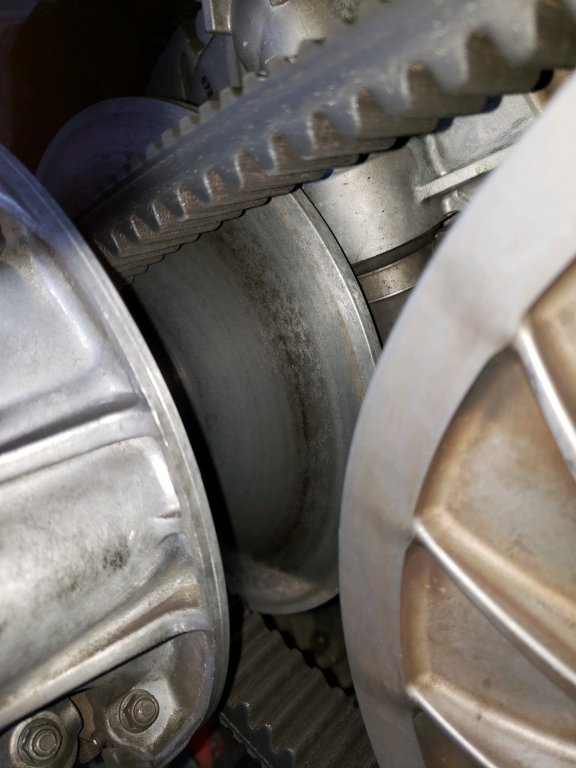

Looking over things on the sled and noticed primary has black ring. Only 20 miles on it. Washed the belt and scrubbed it with dawn soap before installing. Secondary clean as a whistle. Clutch has big venom kit with 33-35 helix orange at 40. Any ideas. Thanks
Where is the ring on the sheave? Bottom? Pics would help

Ya, now that's ugly. I'd be curious to now the setup as that is not happy. Does the movable look just as bad in the same area?

What is your secondary setup? Rollers? Spring and wrap?
35 degree dalton helix, orange thunder products spring set at 3-1, hi-torque clutch rollers.
I can't help you with the TP spring as I've never had one on my drill press scale to know the pressures, I'd suggest to put in a new Version2 Dalton Black/Orange set at 90 with the 825, or a Dalton white Cat torsion spring (same as Cat sno-pro Green) at 9&2, they both have the same pressure on my scale and will serve you well, then tune the primary to that.
I have found that the 825 really does need more side pressure than I thought after blowing two of them last week on the big tunes with the hi-torque rollers. Even on the 825 after it gets a few miles on it, it needs more side pressure.
