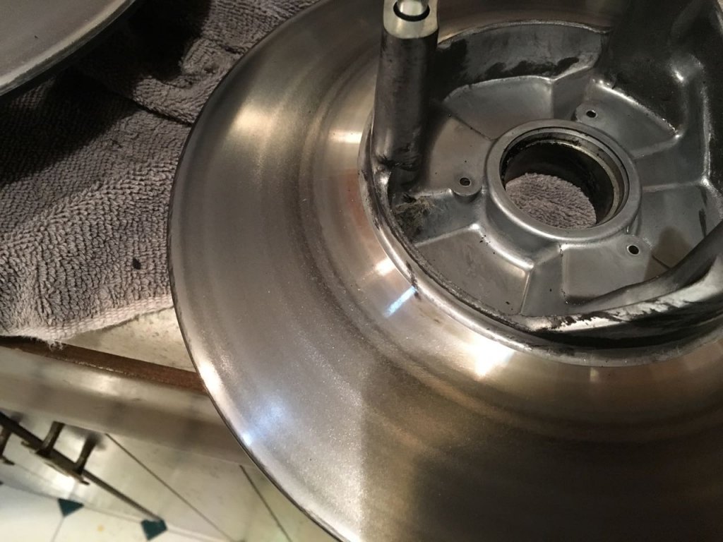

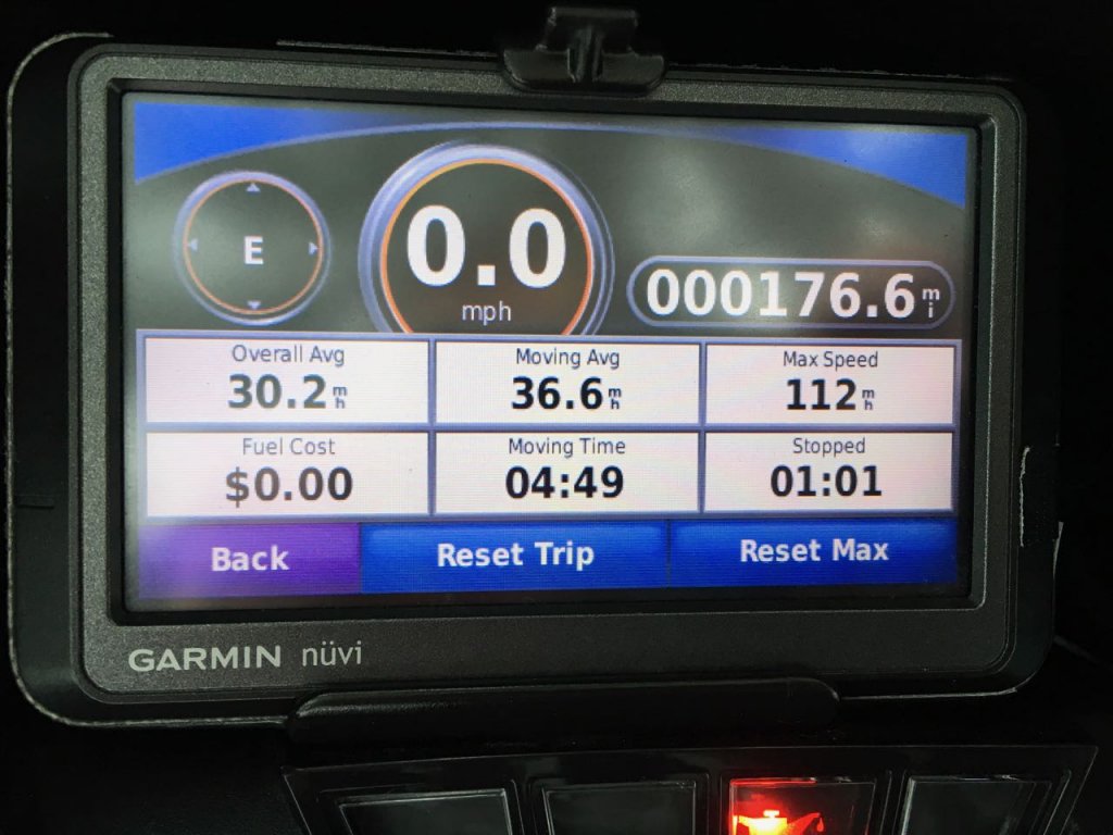

112 on GPS. I must not be getting a full shift out. Here's what the secondary looked like before I cleaned it. Primary marks are a good 1/4"+ from the top.Seems like the 8jp is a good belt for short burst of acceleration. Or at least a break in between blasts like our testing.
8dn is more tolerant to heat and abuse.
When you guys install your adjustable weights make sure you are carefully pulling the primary cover. It is very easy to damage the bushing.
When you say 112mph was that speedo or gps?

You are clearly burning the belt in the secondary. Do you have any oil contamination?
No wonder your top speed is not good...
The 8dn belt should help with the slipping.
