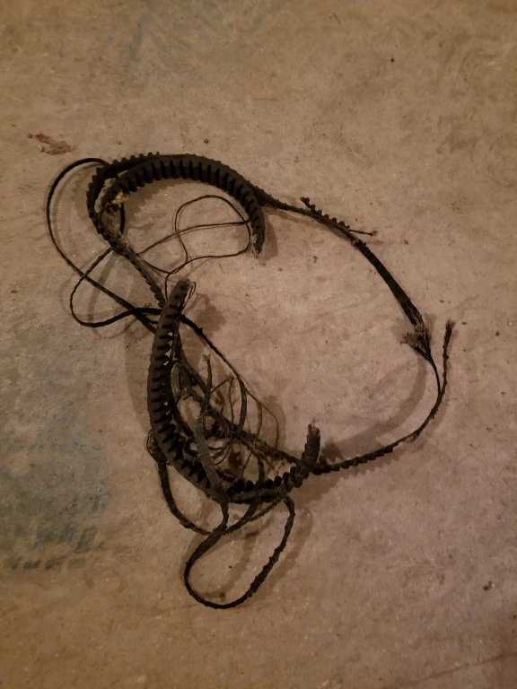

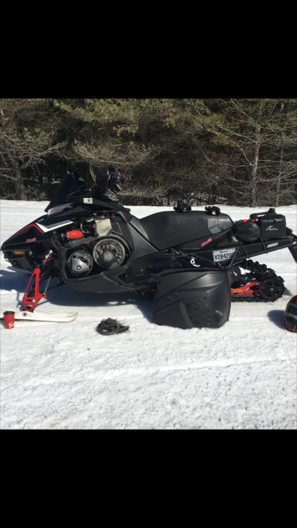

I had my first one of the year yesterday! Xs825 ~~~4200km 17psi
This belt has been over 120mph for MINIMUM 100 time.
It happened at ~~~120mph , wet snow front wind in front of a TIM horton. I had a coffee while cleaning this up..lol
Belt will be replaced under warranty for 15$

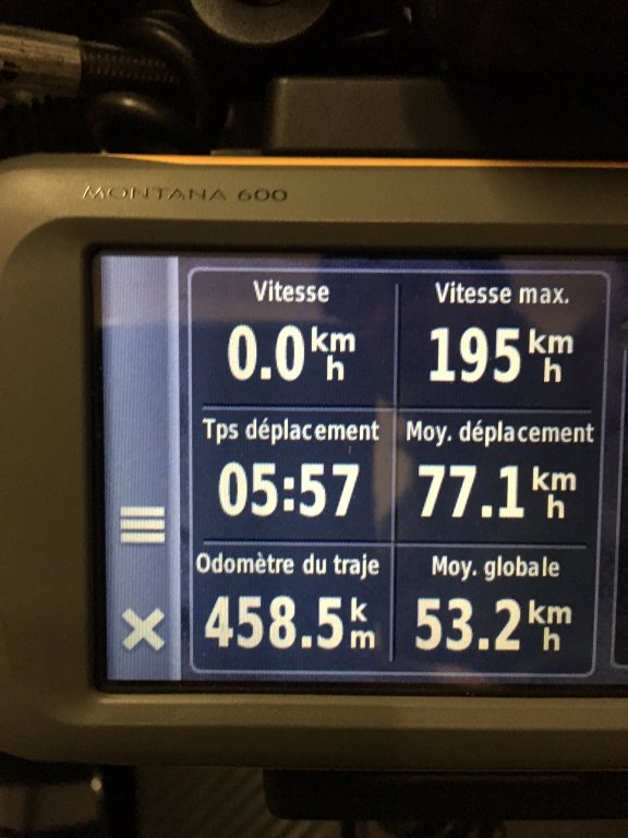

Typical 998T ride stats, 2 minutes before that belt snap whit back wind 195km\h
100% TRAIL BEAST
100% TRAIL BEAST
