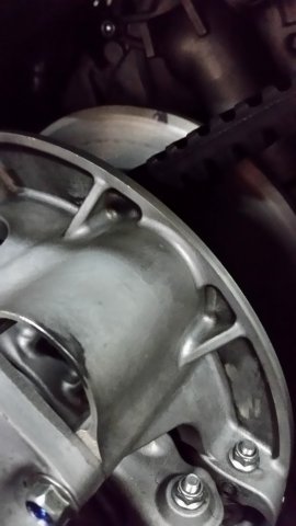

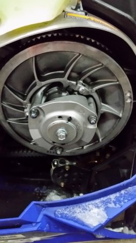

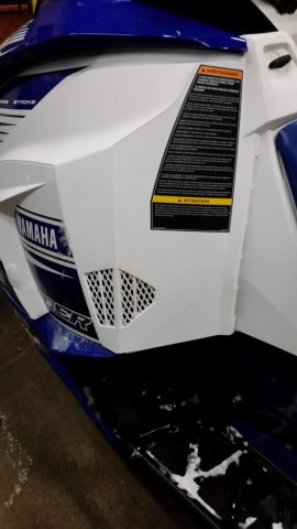

Here are pics from my SW with just over 600 miles and TP clutching
View attachment 124171 View attachment 124172View attachment 124173 View attachment 124174
