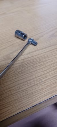

Maybe Im just cheap..lol..but slit the socket to get the T50 out and use a long 8mm wrench for the ones you can get at, and slip it back into the socket for the rest. Works every time.
Did not slice through..just enough to pull out the t5, so torque is no problem. Yeah..coulda bought a separate T 50...didnt know that when I first needed to take the muffler off so used what I had.
