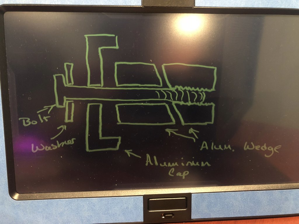

For those who wouldn’t want to weld the shaft like I did here.
You could build a wedge plug. I labeled it aluminium for those who want to save weight. You’d also get the added benefit of have the two materials bind together because of the reaction between the steel shaft and the aluminium plug.
But if it was me it’d all be steel.
I haven’t taken mine apart again in some 1000miles or so. But feel confident it’s good.
Only downfall is that I get a bit more travel on initial engagement of my brakes since my warped rotor now pushes the pads in on either side instead of floating on the shaft. A new rotor would limit this problem, but I don’t see the need for that, personally.
