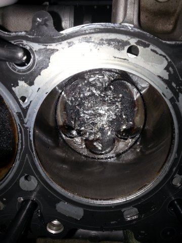

RX1 photos by the way, didn't save photos of the Apex engine I blew up. You find a sled that won't break I am all ears.

Not boosted low miles, just goes to show anything can break.

We can be a little harder on them at 10k altitude. I still say they are the toughest engines, just making a point that anything can break. The blown up Ski Doo in my shop was loaned out and blown up...lol.
