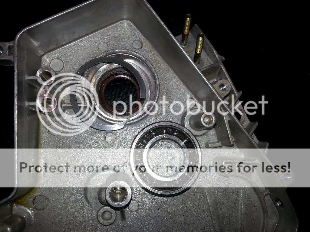

Here are the bearing that went into my chain case.
This is the upper Wobble Bearing replacement:
Here is the lower bearing replacement:

It a PITA!
I've had to change out my chain case twice now (due to me hitting rocks) both time I've had to buy them through Cat because they were either unavailable or on back order through Yamaha. To change out the top bearing you need to remove the retaining clip that holds in the bearing and then press it out from the back side. To do this you need to remove the chain case which involves removing the Jack shaft and the drive shaft.
Now with that being said each time I changed out the Chain case I ended up changing out the Cat bearing and putting the original bearing back in due to the Cat bearing having a cheep looking plastic cage and the Yamaha bearing having a metal cage
This is the Cat bearing
Thanks Tricky great info!
