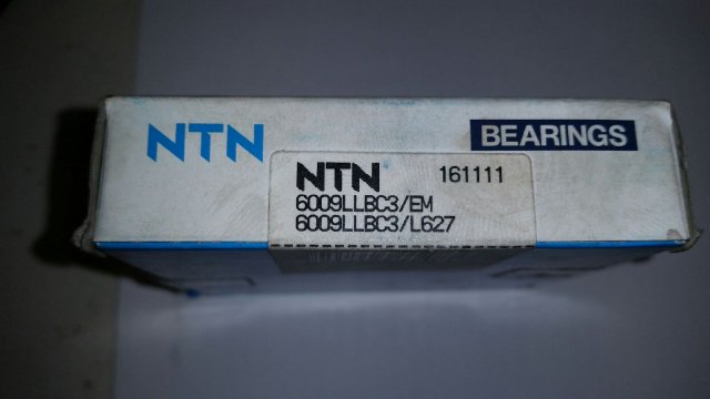

Here are the bearing that went into my chain case.
This is the upper Wobble Bearing replacement:
Here is the lower bearing replacement:
Can this get posted in "just the facts" so I can find it later.
This will probably be 27 pages back by the time I service my sleds and want to use it.
Its in there already. Wobblebearing Replacement
