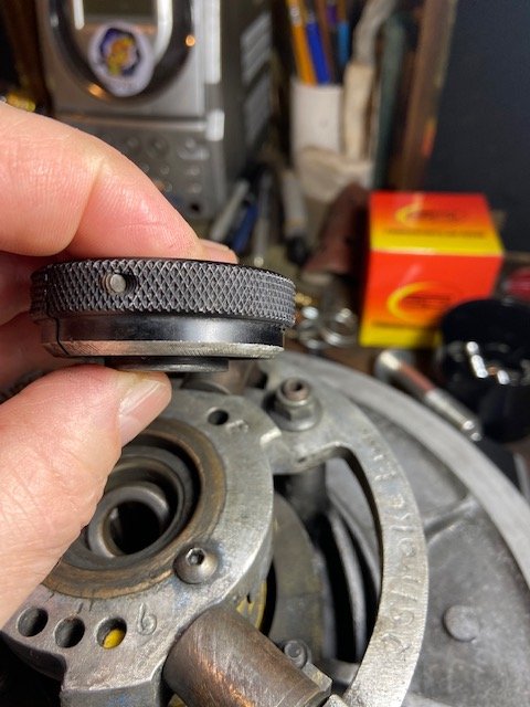

Nitro, you must have eyes like an eagle ...and I must be deaf/dumb/blind (but given my ability for problem solving, this is likely true), but, I don't see a thread "under the outer portion that has the allen head bolt". see more pics.Everything appears to be there. The threads are under the outer portion that has the allen head bolt.(pinch bolt)
Put the clutch bolt in with everything in place, and tighten it up. Then loosen the allen head bolt and turn the outer portion. It is designed to be able to turn with your fingers, but if it won't then gently try some channel locks.
But, I'm gonna do as you say and mount that puppy up and see if I can't make the adjustment. I wonder what the allen head bolt in the circumferance of the knob does (other than obviously loosening/tightening that outer edge? The knob isn't on anything - other than the bolt holding the clutch on). This'll be interesting. Need to run errand with daughter but will jump right on this.

I see them in image 2264.
Can hardly wait for your reaction upon discovering these threads.....

OH .....MY ......FLIPPIN' ....GAWD. Slap my #*$&@ and call me JUDY - the threads are IN BETWEEN the inner "donut" and the "outer ring", (Great art work Heir Steiner!!!!). I now see the light; (and the threads!!!!).So what 74 Nitro is eluding to as that the blue part is stationary when mounted to the jackshaft and the orange part is adjustable in and out by turning it once the allen head bolt is loosened???
Please forgive my 5yr old artistic skillz.![]()
Thank you all SO MUCH for stickin' in there with me on this. Going on now to re-install. And I'm sure the answer will become obvious, now that I know what I'm doing, but, curious: When I secure the secondary on with that chrome'ish bolt, and it's flange is holding down the black knurled "inner donut" ...how does that bolt get pulled out when I'm spinning the "outer ring"? Obviously it does somehow and that separates, or draws together, the sheaves.
THIS IS SOOO COOL. Thanks all. Time me!!! I'll report back.
