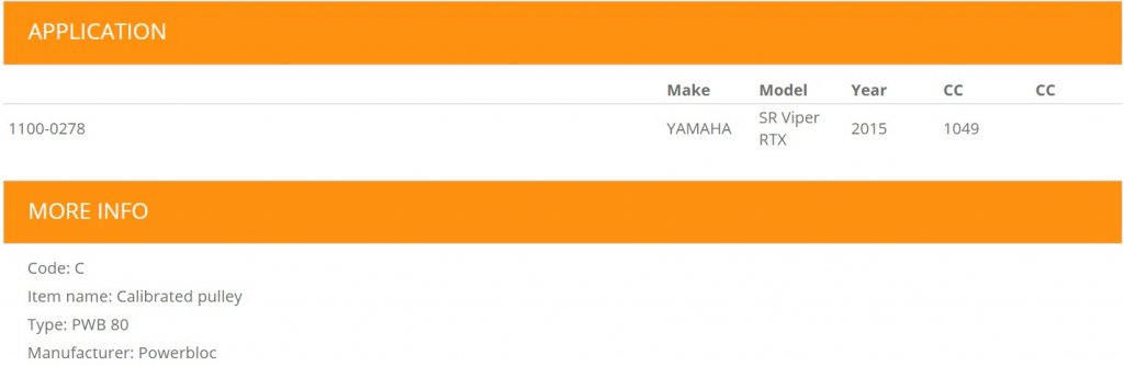

Hi Dan,i was on there site today and for the 2015 viper the price was $570.00 was that Canadian pricing I saw?Cvtech site only goes up to 2015....but they do have a pb80 for viper models, maybe same for SW?
Would be an interesting experiment....there are literally no moving parts that wear on a PB 80, and they are the only clutch that stands up to the harmonics of the 1200 doo.

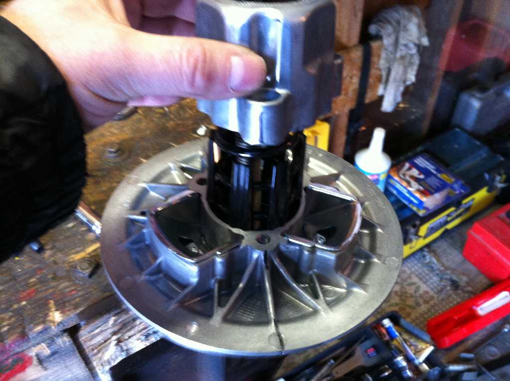

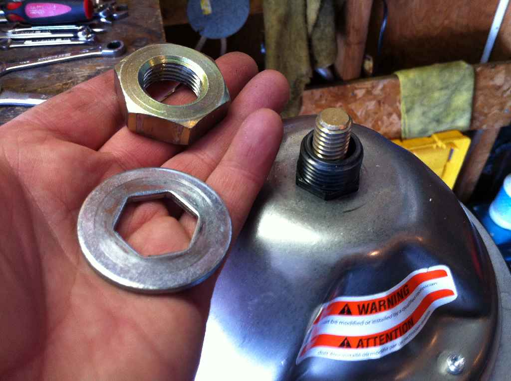

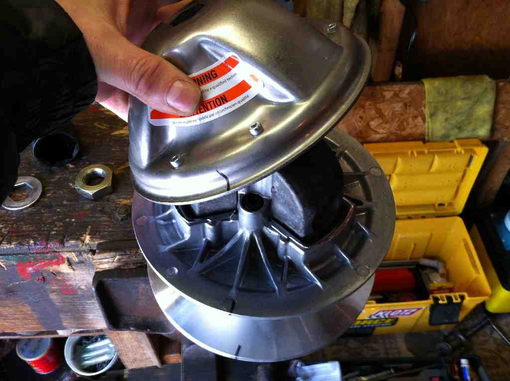

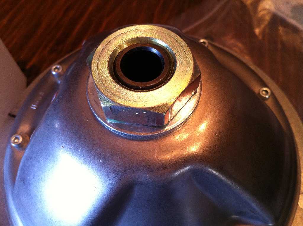

Easy way to figure this all out...in another thread a member ran the pb80 on his nytro, now this may have been awhile back so not sure if he would remember. But search up pb80 nytro section. He sure seemed to like it. I wonder if his was quiet?
So me not knowing the history of Nytro/Viper....are you guys all saying those rattled the same and its NOT clutch, but the stub shaft? I dont ever recall any of this from buds how owned them yrs ago.
As for pb80....well, those things are so darn simple, no arms, no weights, no rollers, literally no moving parts...just a big plastic BLOCK that slides within the angled cap....its so simple its hard to believe they even work.LOL
I just keep thinking, for abit more then the price of a clutch kit, you can buy entire pb80 and likely have quietest clutch made and one that lasts many many thousands of miles without even worry of rebuild. Nothing to really wear out.

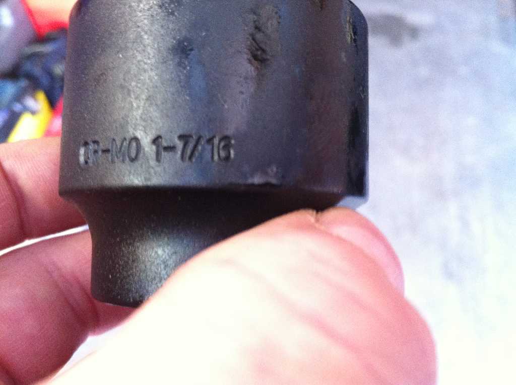

Pete there are only two tools needed, a LARGE 1-7/16 socket to remove the large NUT, and then a HOLDER tool which is cheap too. Many guys with stock 1200s run these clutches, I loved mine. And many with stage 1 around 240hp use them too, but not alot that I know of over 250hp...so not sure the limitations on them. Wowchad is a member on DT and here, and he tells me they have a 2 stage spring setup being worked on for the SW turbo. But there currently is a pb80 out now for nytro/viper which should physically fit....just likely would need a heavier set of weights.
Few pics of my 1200 pb80....
