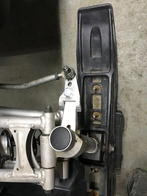

SOLD....!! Looking forward to installing and testing it out!!Ok....Kits are up on the website for ordering. To keep costs down I was able to utilize the stock tie rod ends and opted to supply good used tie rods(as inventory lasts). Retail will be $250 for the deltabox kit. Settled on SS MPS arms, as the 6061 aluminum arms were stress cracking for me when I formed them. The stock spindle arm has fine cast lines on the edge. These will need to hand filed for the linkage arm to fit. Aside from the filing, the installation concept is the same as the procross kit. I will get installation instructions updated as soon as I can.

How do you get the toe in set right with that bend in there ? It looks like you would have to go one full turn at a time.
Ken.....
If full turns don't get you close enough you can always unbolt outside end from spindle and give it a full turn which is essentially 1/2 a rotation of tie rod since the inner is not being adjusted.

I guess that the farther out from the original hole it will move the tip of the ski less so it wouldn't be so much with one full turn at a time.

In place of typed up installation instructions I'm going to start using videos. Here's one for the delta box MPS kit.

Out on the trails now..!! My 03 Handles better than ever..!! Install was a breeze..! Well worth the price being able to steer my sled.I just found this thread, I asked a question about this kit on the RX board

I really like mine !! It makes a big difference.

What setting are you running it in? Easiest?I really like mine !! It makes a big difference.

I actually ended up using the middle setting. Some of the trails are so tight that I ended up turning the bars all the way to make the corner. The middle setting is a nice compromise between steering effort and actually turning. I also tried the stock skis with a shaper bar on one side and a Woody's Dooley on the other, but I didn't care for it. Once I put my Simmons Flexi Skis back it worked way better. The steering was easier and the sled turned better to. This is a great product. Some people with shorter track sleds may run the easiest setting and turn just as sharp as I do on the middle setting.
