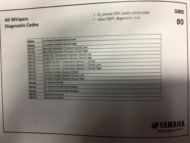

Just updated the Cat diagnostic tool at work and it showed the update for the 7000 ECM
Also codes for O2 sensor are eliminated so no need for a bypass plug just unplug and remove sensor and plug the hole if wanted. Sensor will be ruined if run without being connected.
If this is the case and the 02 sensor is removed, could I then plug my Power Commander POD-300 into the hole so I can get AFR readings on the POD-300?
Yes. You will need a adapter for the O2 sensor your POD requires. Innovate sells a nice one. Here is the info from Tech Update Book. All O2 sensor codes are eliminated.If this is the case and the 02 sensor is removed, could I then plug my Power Commander POD-300 into the hole so I can get AFR readings on the POD-300?
Awesome, great to know! Thank you Cannondale.

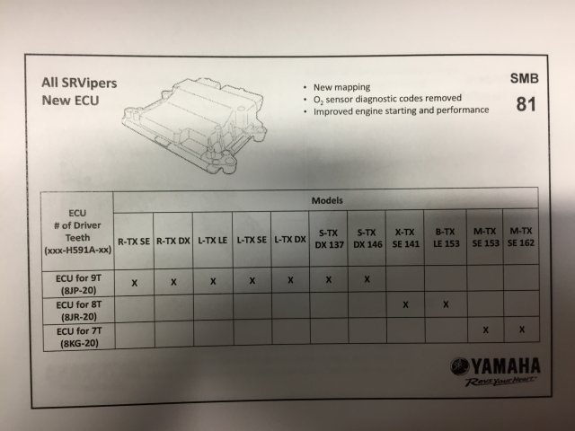

Yes 17 Viper has flash already. It does have info on Sidewinder shaft and bearing. The sidewinder shaft is thicker entire middle section but smaller dia to fit the new bearing. Is also updated chain tensioner. In Sidewinder and Viper. Not sure why. Will take pics of those next time I am there. So you would definitely need entire shaft to fit the new bearing. Not stated is whether it can be retrofitted like they did for the 16 setup. Only worry to me is the length where 15 wide gear fits. Is gear wider at shaft than current? Is not said. But everything might be needed for a conversion including gears chain,tensioner,shaft and bearing.Great! So I guess 17 Viper already has the new flash?
Somethings from Tech about the new jackshaft and bearing in 17 Viper and Sidewinder?
Here is a little more on subject. Obviously different ECU for Speedometer accuracy
