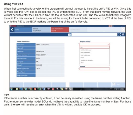

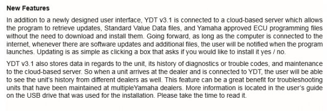

Little more info. The US dealers and maybe other countries have recieved a update to the YDT tool. It is cloud Based now and should be more reliable. Nobody has said it but maybe this will cure the variances experienced after last flash. There is no longer downloading involved so as I understand it the Laptop was the middleman now the middleman is eliminated and the flash and any other info goes right to your sled from Yamaha. This makes me feel much better and I bet it is much more successsful. The computer guys here will hopefully agree since I know very little other than the old system didnt work. I will get the flash as soon as its available now. Tech who just got back from class said flash is coming to us all. This is good news. Couple things from the Update to the diagnostic tool:
