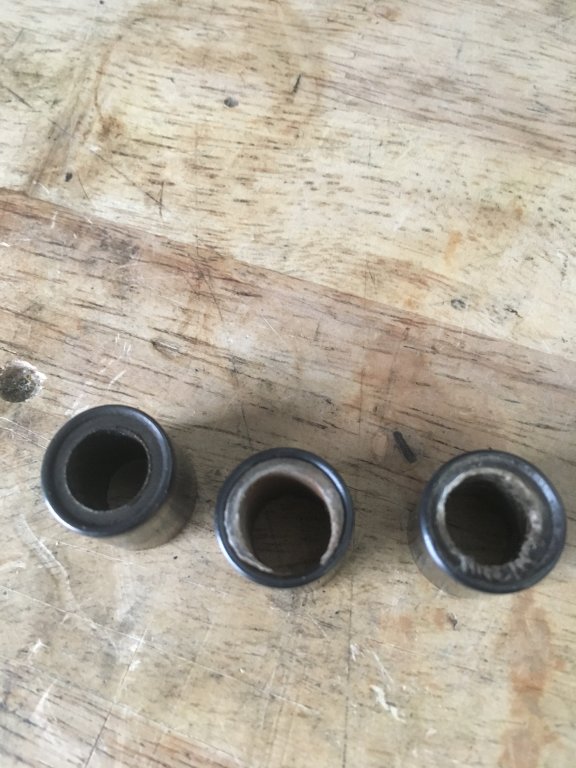

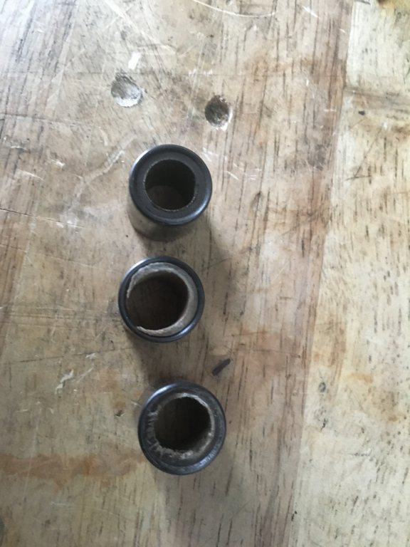

View attachment 139458 View attachment 139459 Hi rockerdan. No i didn't contact Loan you think i should? Look at the one in the middle, the weight was about to flip the roller and babooooummmm.......:-/
Byam, something is not right in this picture.....the bushings should all be black like the top roller.
I am going to call Lonn at Thunder Products and make sure he knows this issue.
Those are "fiber"type bushing and like all roller the bushing is coming out clockwise. When the roller can't turn the bushing worn extremely fast.
The one that looks correct in the picture was seized also (bushing out clockwise)

After talking whit M Lonn (gentlemen) he asked me to semd him back the roller....Byam, something is not right in this picture.....the bushings should all be black like the top roller.
That's what i received
